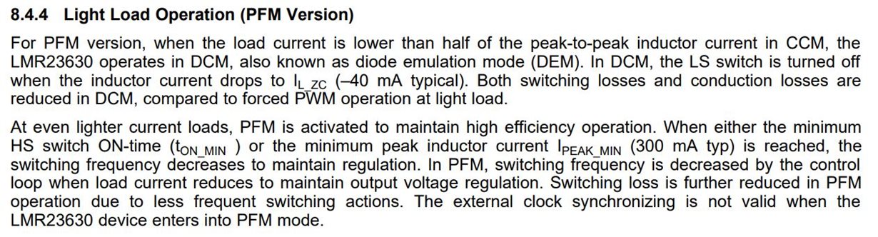

I could find that entering PFM mode is when the minimum peak inductor current is under 300mA.
What is the meaning and where is the point of minimum peak inductor current exactly on the graph?
This is tested in condition of Vin=12v, Iout=0.1A.
Imax = 650mA, Imin=170mA.
