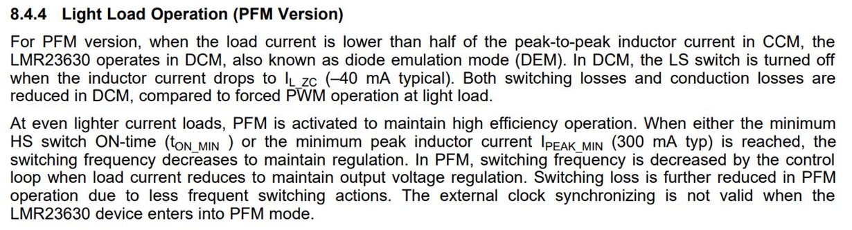

LMR23630: Condition of DCM, LS switch is turned off
Part Number: LMR23630
I could find that the condition of LS switch is turned off is when inductor current drops to -40mA (I_L_zc) on the datasheet.
Could you explain the where the point of I_L_zc is on the graph? first arrow(The line)? or second arrow(Valley)?
Thank you
