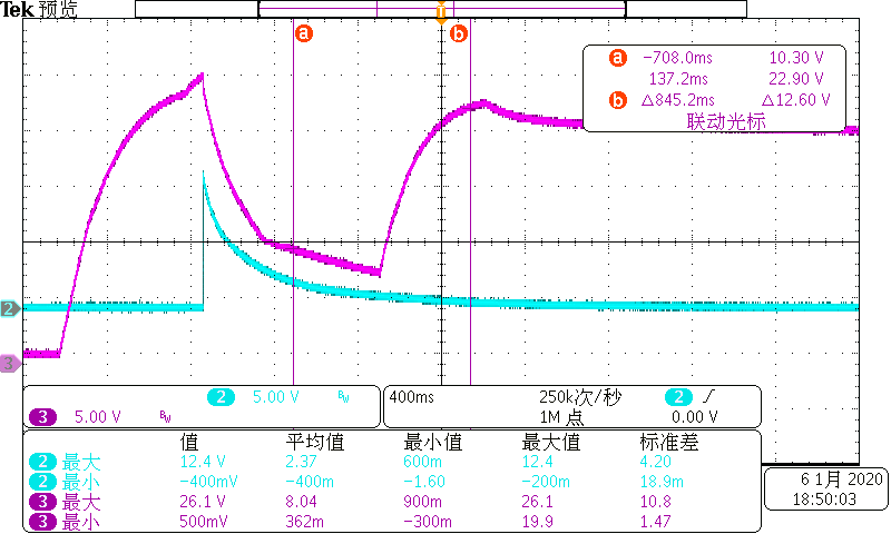

I used UCC256302 with PFC IC UCC28180,
I find it cannot startup.
the fig  above FYI. CH3 for VCC, and CH2 for RVCC;
could you have similar design?
and give me some tips for the trouble.
thanks.

  • I think the LLC part is ok and tried with 400Vdc input to LLC part , the result is positive.
    the problem is plus PFC(UCC28180), and UCC28180 VCC is from UCC256302 VCC with a linear circuit.
    do you have the similar application? perhaps the LLC IC startup current is not enough.

  • another issue VCR wave form is abnormal when no load while others load is normal.  do you have comments?
  • Do you have a waveforms of normal and abnormal?
    Is this causing the converter not to work?
