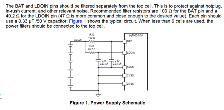

Based on design guideline, we commend the series value is 40.2 ohm. 47 ohm is more common and close enough to the desired.
However, 49 ohm should be more common and we would like to have your comments if we can use 49ohm.
This is the datasheet recommendation for LDOIN pin (see page 6, "Pin Functions", "LDOIN" pin of the datasheet):
"Connect LDOIN to the positive terminal of the highest cell in the stack through a 40Ω to 50Ω resistor".
