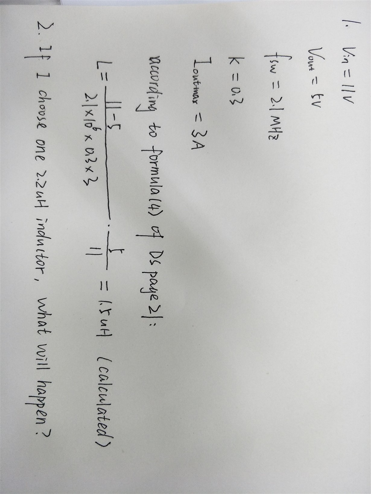

Dear expert:
Can you help me understanding the follow paragraph of Chapter8.3.1 in DS, please?
thanks a lot!
Limit the current into the powergood flag pin to less than 5 mA D.C. The maximum current is internally limited to about 35 mA when the device
is enabled and, about 65 mA when the device is disabled. The internal current limit protects the device from any
transient currents that may occur when discharging a filter capacitor connected to this output.
