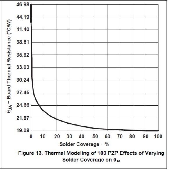

could you ask your thermal modeling team based on specific condition from 0% - 100% soldering coverage on its thermal pad?
Layer : 2
Board thickness:1.6mm±0.19
Copper thickness:18um
Area:95mm x 85mm
expected graph looks like below
