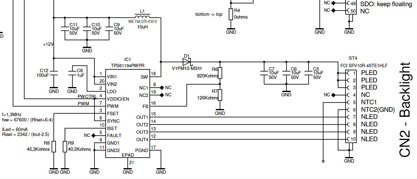

TPS61194: Design Review and NTC question
Part Number: TPS61194
I need to design a backlight solution for a 4P11S display. The total current is typ. 240mA., i.e. 60mA per channel. Forward voltage is specified to be above 30.8 and below 36.3V.
Could you review the attached schematic for correctness?
Also, the LCD features an NTC for current reduction.Is there a way to couple the NTC with the Riset-resistor for current reduction for higher temperatures?
Michael
