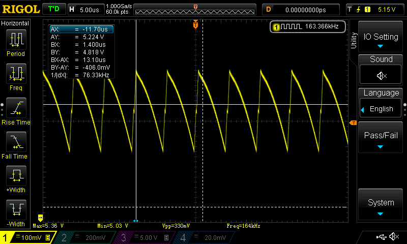

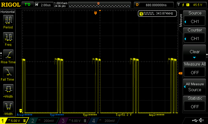

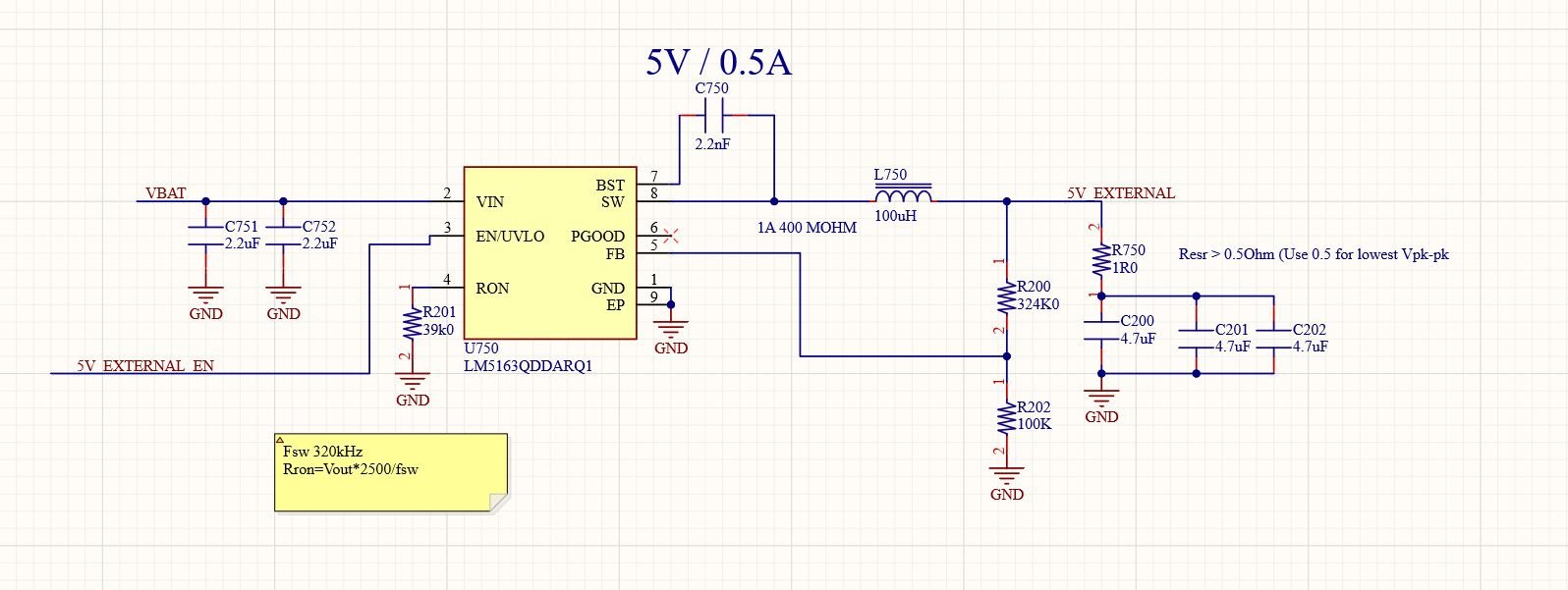

The Switching frequency for LM5163 is based on Ron resistor:
Ron = Vout (2500) / fsw
We use 39K resistor (verified and measured) , and expect 320KHz switching frequency, with Vout = 5V  . (Vout is measured to be 5V)
Would you please be able to provide any input on the unexpected Fsw? This is affecting the Vout pk-pk ripple.
Capture below is with a load on 5V , of approx 0.2A.
