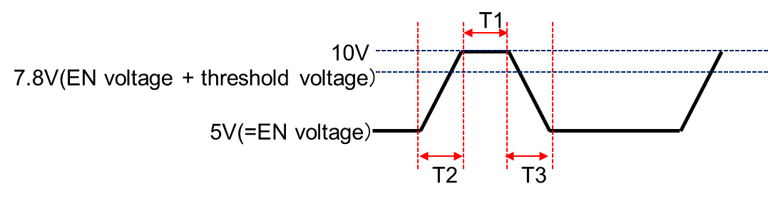

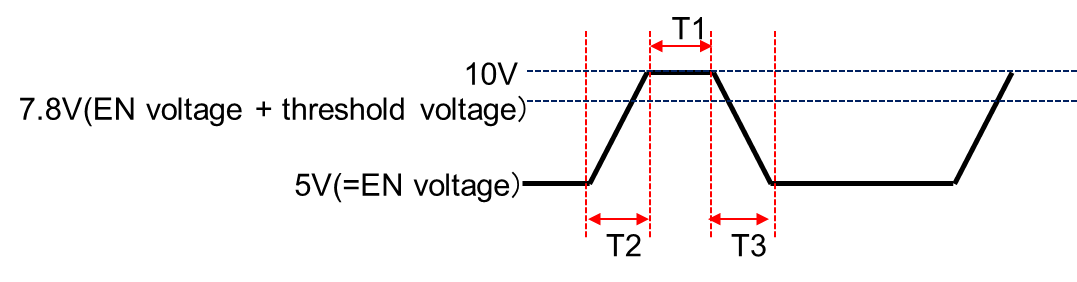

I have questions about SYNC input. Could you please let me know below?
  1. Is there any requirement for T2 and T3?
  2. For T1, can I think its requirement is Tsync_min?
  3. Is it correct understanding that the device detects timing of external clock's low to high edge?
  4. How many external clock cycles is required for the device to start running with the external clock?
  5. Datasheet p.13 says "SYNC amplitude threshold of 2.8 V (typical)". How much variation on the threshold voltage should we consider? for example, like it should be within 2.8V+/-100mV.

    Answering your questions below:
    1. Is there any requirement for T2 and T3? - It is not spec'ed. The design has no specific requirements regarding T2 and T3.
    2. For T1, can I think its requirement is Tsync_min? - Typical minimum On and OFF time is 100ns (We don't have min and max for this spec)
    3. Is it correct understanding that the device detects the timing of an external clock's low to the high edge? - Yes
    4. How many external clock cycles are required for the device to start running with the external clock? - There is PLL inside the design, and it cannot be spec'ed. It depends on the temperature and process corner on how much time PLL takes to get lock with an external clock.
    5. Datasheet p.13 says "SYNC amplitude threshold of 2.8 V (typical)". How much variation on the threshold voltage should we consider? for example, like it should be within 2.8V+/-100mV. - The EC table says 2.8V(min) while the EN/SYNC description says 2.8V(typ.). We confirmed internally with designer and Product Engineer that 2.8V is actually "minimum spec" not typical.
