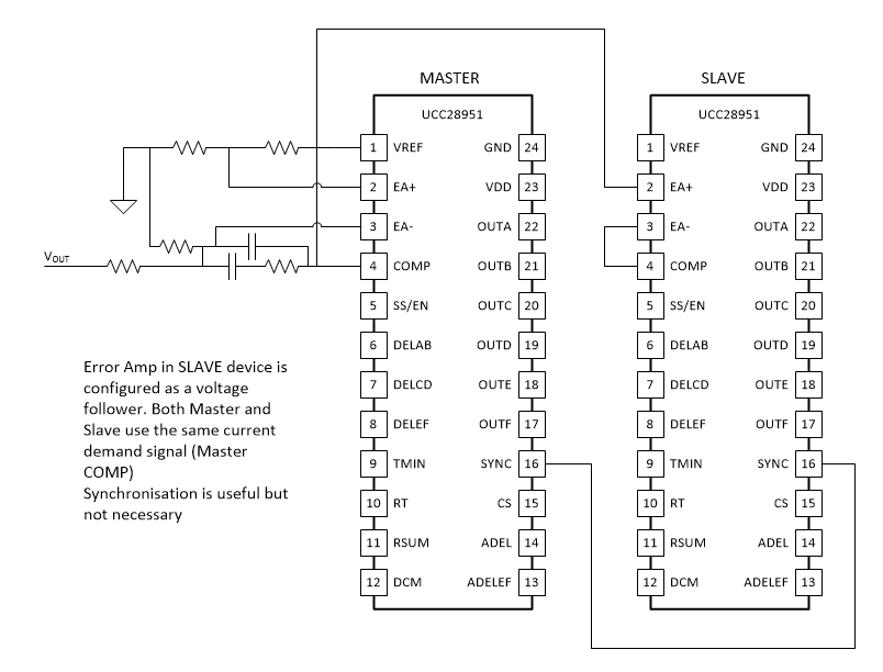

Dear Team,
Do we have two UCC28951 with master and slave circuit?
Customer want to implement it with current sharing.
BR
Kevin
  • Hello Kevin
    Yes, we have this diagram. The output of the error amplifier from the Master is fed into the Slave. The error amplifier of the Slave is configured as a voltage follower. The result is that both devices see the same COMP signal and this forces equal current sharing.
