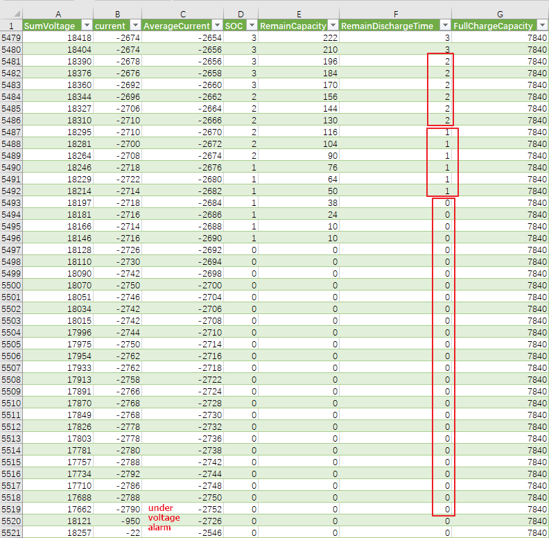

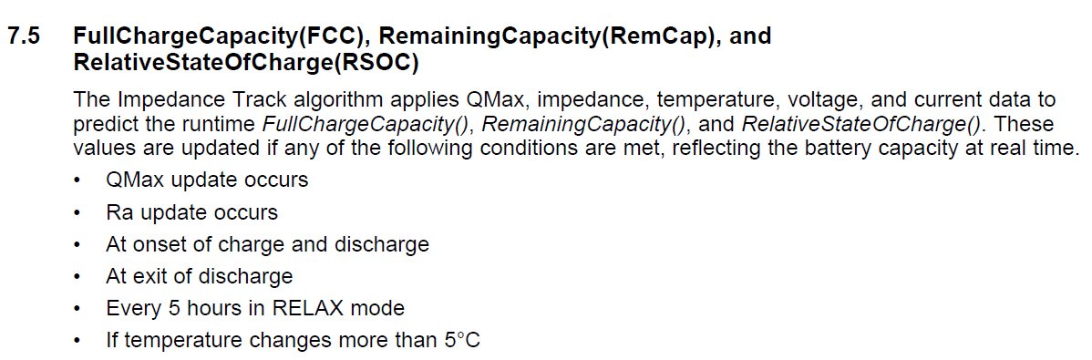

The questions are:
1. RemainingCapacity keeps 7760 [cWh] for 63 seconds and then starts to decrease. Why not decrease from the beginning?
2. RemainDischargeTime=2 [min] only keeps 6 [s] and RemainDischargeTime=1 [min] also keeps 6 [s]. It should be 60[s] or close to. Could you please give some explanation? (RemainDischargeTime is the return value of RunTimeToEmpty())
3. RemainDischargeTime=0 [min] keeps 27 [s] before reach under voltage condition, Why RunTimeToEmpty() does not take the extra 27s into account?
Any feedback and comments are welcome. Thanks in advance.
