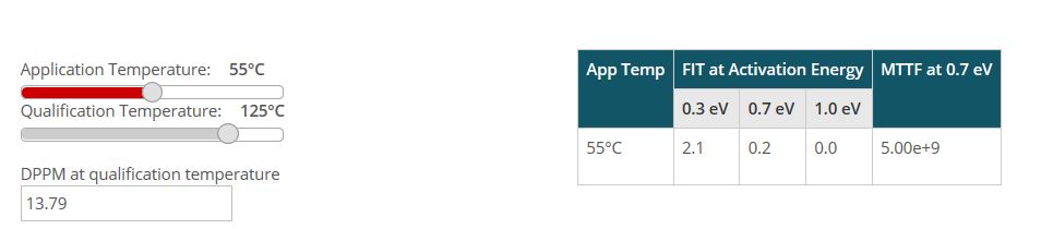

    1) I just tried to check the application FIT for UCC21222QDQ1 at 55degC in the de-rating tool (refer belwo image). I dont know the DPPM value. So derived from sample sizes and failures mentioned in link below.
    I am getting 0.2 FIT for 0.7eV which is lower than the base FIT value given in link below.
    https://www.ti.com/quality/docs/estimator.tsp?OPN=UCC21222QDQ1&CPN=&partNumber=ucc21222#resultstable
    Could you please clarify how this DPPM value is derived? What values should i use for sample size? and no of failures?  Is this a kind of estimated field failure data we need to use based on past experience??

    -          We use HTOL de-rating with a combination of Chi-squared model for our FIT estimations.
    I cannot comment too much on MIL-HDBK-217E it seems they use some type of transistor count based estimation with some additional factors, which seems outdated and is not our approach.
    • Please note that our estimator is based solely on technology grouping (which is composed of data all devices in the same technology group) and is not specific to any device:
      TI.com page: “TI’s DPPM/FIT/MTBF estimator search tool allows you to find generic data based on technology groupings to estimate these typical questions and shows conditions under which the rates were derived.”
    -          DPPM is derived using the Chi-squared fail estimation method (used in zero-fail circumstances). Sample size is can be found on estimator page for the product.
    • Also caution must be exercised when using the Temperature change FIT page, this page is not compatible for devices that are in multi-chip module (MCM) format. We are investigating updating the calculator to make it compatible, but for now it only shows results for single die devices.
