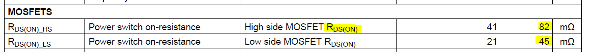

In datasheet of LM61460-Q1, Rdson is specified as below. Can you tell me what load condition(A) it was measured at? Is it 6A, or is it anther condition?

RSDon is independent of load conditions. We measure RDson under testmode and with no load and full load condition both. We usually take delta between two operating conditions to nullify the common irregularities bought into the measurement for being extra accurate.
