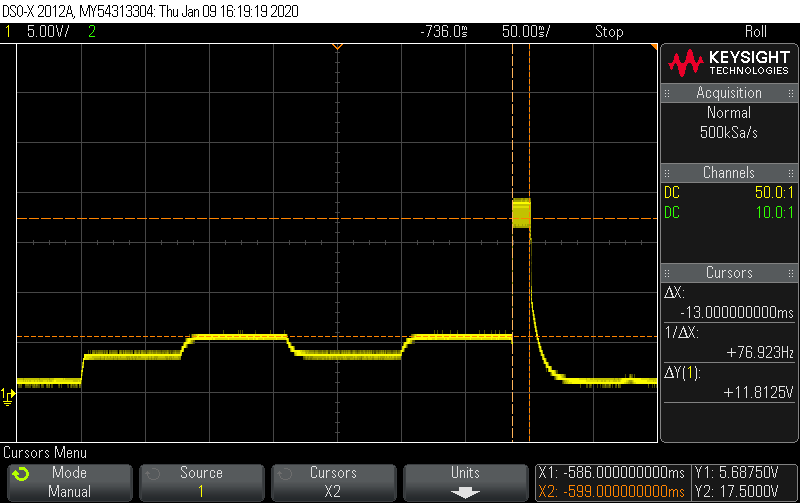

Hi. I am developing POE switch and at the moment I am testing it with different PDs.
I am implementing power budgeting so I need to use semi auto mode.
Settings of TPS23861:
  • A bit set to 1(by internal pull up).
  • SEMI AUTO MODE
  • Detection and classification enabled on all ports
  • Two-event classification enabled
  • tSTART=0b10; approximately 120 ms
My problem:
One particular PD which works fine with other PSE equipment do not start with TPS23861 in SEMI AUTO mode.  It power ups fine in AUTO mode.
This is the waveform of detection and classification:
Whats happening in I2C bus:
Port  1 class and detection(0xC) register shows: 0x14, which means Class 1 and Resistance valid.
Then I set POEP1 bit to 0, ICUT Port1 to 1 which gives 110 mA current limit.
Then I enable port with PWON1 bit.
Approximately 400ms after PWON1 bit is set Class/Detection register(0xC) of port 1 changes to 0x3, which means Class Unknown and Resistance too low.
This 0x3 value persists for approximately 1 second, then for about 40ms I read register(0xC) value 0x4, which is Resistance valid and Class unknown.
Then 0xC register shows 0x14 again.
Also when I read Start/ILIM Event Register(0x8) register it shows STRT1 bit active, which indicates that a start fault occurred at port turn on. This may be caused by:
1. Overcurrent (foldback) condition at the end of tSTART.
2. Detect or classification fault following a pushbutton PWON command in Semi-Auto or Manual Mode.
3. Overcurrent or class mismatch on second finger in Semi-Auto or Manual Mode.
From all information above it seems like for unknown reasons Class is changed in the PD which stops port from being Enabled.
Why this PD is powered in Auto mode?? Any ideas? I would really appreciate help!
Karlis
  • Hi Karlis,
    That's very interesting behavior. Can you capture the port current in semi auto mode and auto mode? I want to verify if inrush current exceeds the inrush limit. In addition, did you see consistent detection and classification result (detection valid and class 1) before issuing power on command through 0x19? Thanks.
    Penny

  • Hi Kalis,
    In auto mode, the port perform detection and classification once the PD is connected and power on the port right after it detects a valid PoE PD(valid detection and classification). That's why you only saw one cycle of detection and classification in auto mode before the port is turned on.
    In semi auto mode, the port keeps doing detection and classification after the PD is connected and before the power on command is issued. Once there's a host command to turn on the port through 0x19, the PSE finishes the current cycle of detection and classification and turns on the port. That's why you usually see more than one cycle of detection and classification before the port is turned on in semi auto mode.
    From your measurement and observations, looks like the PD has issues present consistent detection and classification during continuous detection and classification. In auto mode, the device takes care of turn on automatically as long as it sees a valid detection and classification. While in semi auto mode, it relies on the host. It is possible that while the host sees a valid detection and classification then the host issues power on command, and the PD presents invalid detection and classification in the last cycle and the PSE refuses to turn on and reports start fault.
    Does that make sense to you? My suggestion is to do a sifos test or get an EA certificate with your TPS23861 board and as long as it passes, your PSE system is compliant and it should work fine with compliant PDs and you don't need to worry about the noncompliant PDs. Thanks.
    Penny
