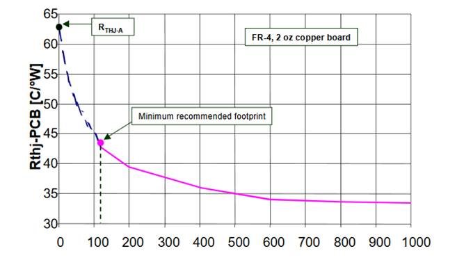

How can I achieve good heat rejection of Power MOSFET CSD19535KTT with D2PAK package?
While comparing to the base area of MOSFET, I am increasing the copper area on the PCB like 10%, 20%, 30% and so on.
while doing like that when i can get the good heat rejection point? Also i wanted to know how i can find the saturation point of heat rejection when we go on increasing the area of copper deposited on the PCB.
what are the effects of Heat transfer when the area of copper on the pcb is increasing?

    Thanks for providing useful information, but can I get in detail if i increase the copper area on the top layer of my FR4 PCB when compared to the Tab area of MOSFET, How the heat flow is getting to be effected? Can you suggest any application notes from TI that can be referred?

    The paper which you suggested in the previous reply, they considered the thermal vias in their case. But i wanted to know the effect of copper solder area under the Tab of the MOSFET without considering thermal vias. Can i get the information about the effect of copper solder area by consideration of vias and without consideration of vias is same?

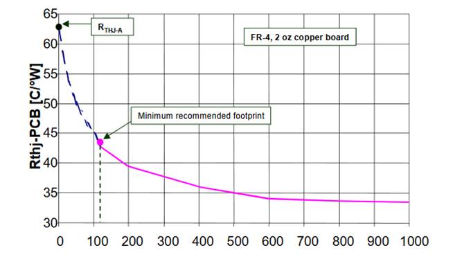

    I managed to locate some data that shows thermal resistance, junction to pcb, vs drain pad area on a single layer FR4 board with 2oz Cu layer. Area on x-axis is in mm2.

    I am unable to view the file which you sent in the last reply. Can i get a clear view of that file?

    Hopefully you can read this image.
