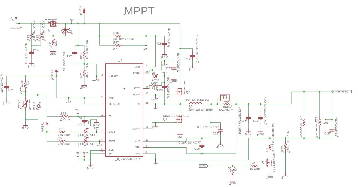

We designed a solar charger for a LiFePO battery.
The charger is part of a board that has many other functionalities including driving 3 BLDC motors.
After the initial (and extensive) testing of the board, we manufactures 150 of them for a larger scale testing before going to mass production.
We installed them in the field (Outdoors solar plant) and we saw that about 10 of them are not charging.
We inspected the boards and found out that the BQ24650 has been damaged.
Further testing shows that the resistor Rsr (the one between SRN and SRP) is burnt as well. Note - it was burnt to open not to short.
It seems to me that some extensive current was flowing there and that caused the issue.
I replaced the resistor with a working one but the issue remains - the BQ24650 was damaged and will not charge.
We need some help please understanding what might cause such a behavior before going to mass production.
The parameters of the system are as followed:
5 cell LiFePO battery (16V to 18V).
Max charge current is set to 4A
Solar panel is 50W 28V
Rsr is 10mOhm, 1W resistor.
MPP is set to 21.5V
Attached are the schematics and measurements comparison done between a working board, and a malfunctioning one. For the malfunctioning board we replaced Rsr to see if it solves the issue but it didn't.

        Do you have a test procedure to evaluate performance before sending out into the field? SRN and SRP are sense lines, and do not carry current through them. The total charge current definitely passes through RSR, but if it is indeed 1W rated, then it should be able to handle the power dissipation across the resistor.
    If you have an EVM available, are you able to solder on the BQ24650 that are not working on your board, to the EVM to evaluate if it can work on the EVM?

    I have another theory - if there will be a short circuit between SRN and SRP, PH theoreticly will produce infinate current - could that happen and harm the part and Rsr?
    Tomer
  • Hi Tomer,
       This part has battery short protection as well as a secondary cycle by cycle charge overcurrent protection:
    The charger has a secondary cycle-to-cycle over-current protection. It monitors the charge current and prevents the current from exceeding 200% of the programmed charge current. The high-side gate drive turns off when overcurrent is detected and automatically resumes when the current falls below the overcurrent threshold.

    Also, shorting SRN and SRP on a working board didn't do anything except by increasing the current by 1 amp.

      The conditions you have are in the recommended operating range so I dont see anything out of the ordinary that would cause this damage. Usually damage is caused by an over voltage or over current condition.
    Is it possible to capture when the damaging event occurs?
