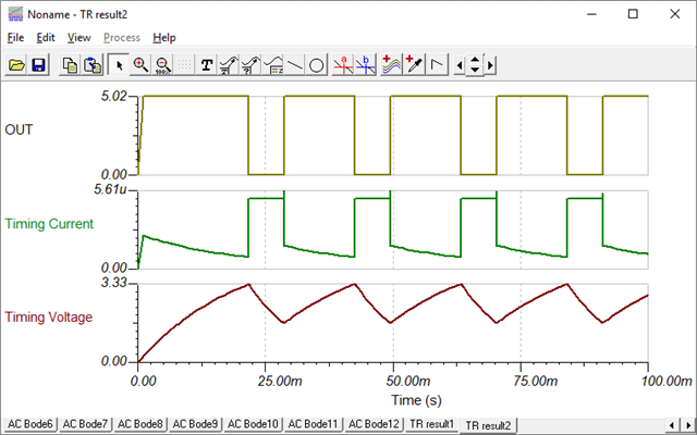

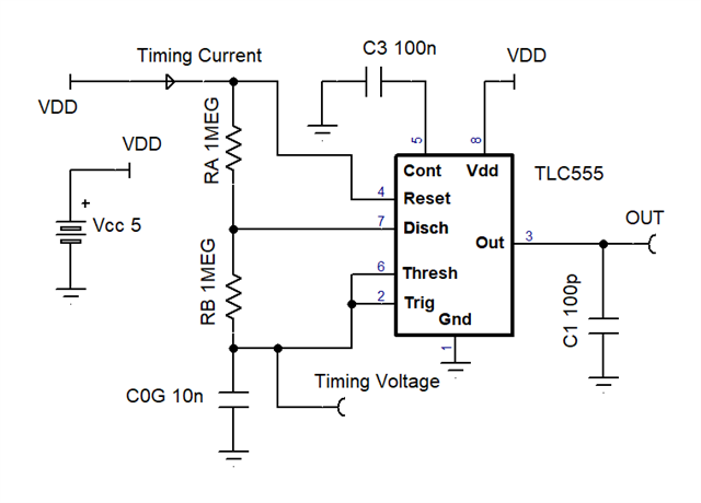

I know the "LTC555" has a very low power consumption(250uA max, 1-2mA for the capacitor and resistors). I was wondering is it possible to decrease this by not dumping the capacitor energy when the timer is low, but storing it somehow, perhaps a second capacitor or a coil inside? I don't know what the efficiency will be, is it even possible?
