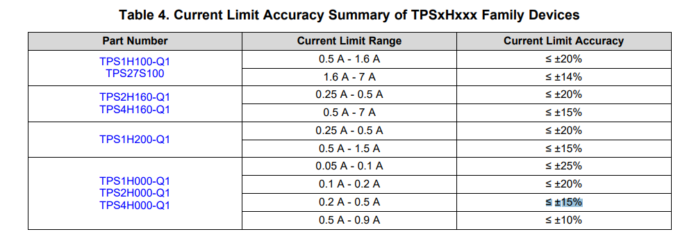

1) In the data sheet it's written the internal current limit when CL is connect to ground and the minimum value is 1A and maximum value is 1,6A. This range is very wide. In this way, I can not have a precise maximum current value to design the power supply.
2) Because I want 300mA maximum current on load, I want to use an external current limiter using an external resistor between pin CL and ground. But I read the accuracy is up to +/-25%... is it correct? If it's correct, is it mean the current limit is between 225mA to 375mA. But which is the reason of this bad accuracy?

  • Hello Federico,
    I would recommend reading http://www.ti.com/lit/an/slva859b/slva859b.pdf if you have not already done so as it has a lot of really good information about how the current limit is setup on the device.
    At your load voltage of 300mA you are looking at ≤ ±15%. Refer to the table below from the above application note:

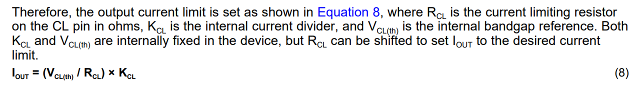

    If you want to limit the current to 300mA as reference you have to use the external resistor for the current limit. Specifically with this device you will use the following equation (taken from the above app note):
    You will need an RCL value of 800Ω. Without a resistor the nominal current limit for the device is a range from 1.0A to 1.6A, with a nominal value of 1.3A. This is useful for when there does not have to be an explicit current limit on the load, however conditions such as short-to-groun want to be accounted for.

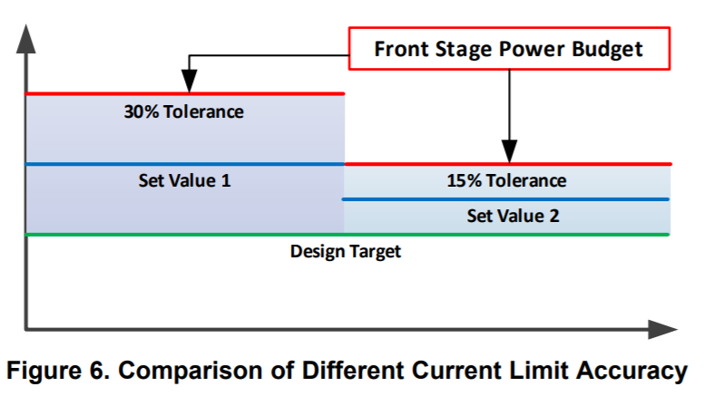

    1) The accuracy variations you see at higher output load currents versus smaller load currents is due to the inner workings of the current limiting circuitry. While these accuracies might not be in line with a device such as a current controlled load switch they are competitive as far as high side switches. The way that I look at this is that these margins can be factored in holistically when it comes to the whole application design. Figure 6 does a good job illustrating this in the referenced application note:
    Essentially what this is saying is that if you are setting your current limit to a certain accuracy range that you should make sure that your upstream power supply will operate properly at the worst case margin and not droop/degrade.
