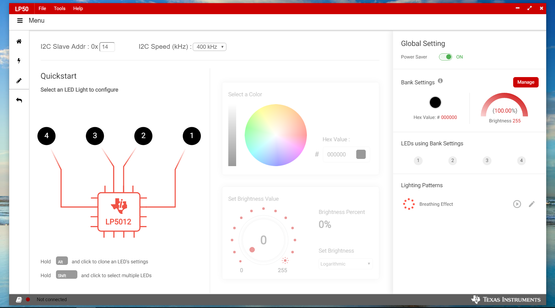

LP50 EVM s/w is sending wrong I2C address to the EVM. It makes not possible to communicate with EVM board.
In the datasheet, I2C address of Lp5012 is 00101XX. If I set 00 for ADDR selection, it will be 0010100 = 0x14. But In SP50 EVM S/W, I only can choose 0x28. I also checked with Oscilloscope and S/W was sending 0101000 not 0010100.
Please fix this asap! I need to evaluate IC by this Wed.
