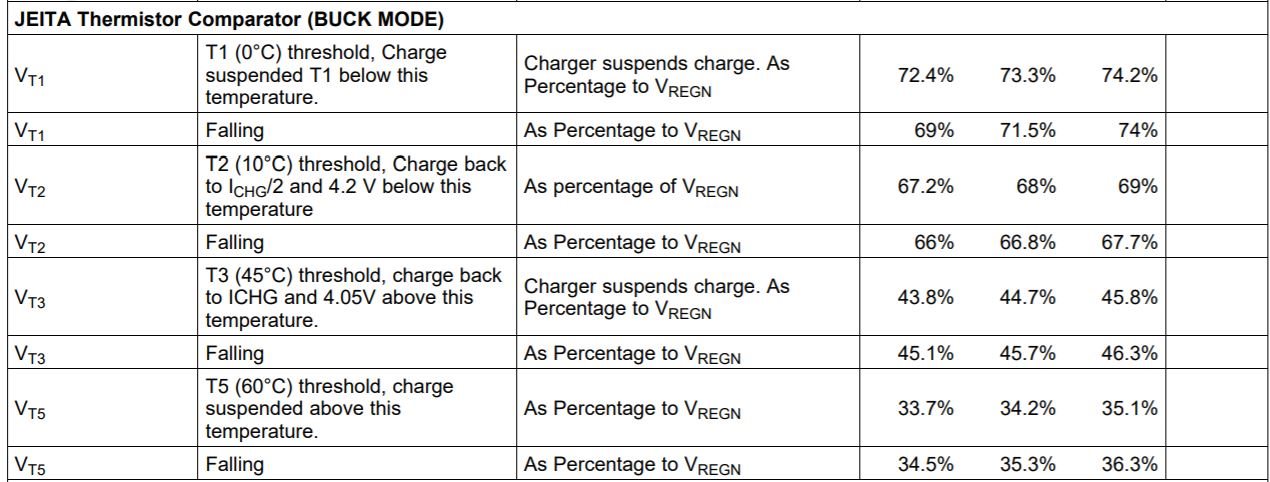

    1)  When using the charger alone with the gauge, the thermistor should be either connected to the gauge or connected to the charger, but not both because the charger and the gauge have different specs on the thermistor connection. The BQ25601D has below TS pin specs, while the gauge may have different specs. The BQ25601D follows JEITA charging profile (9.3.7.5 JEITA Guideline Compliance During Charging Mode). Connecting the thermistor to either the gauge or the charger will protect the battery charging based on certain temperature profile. If you choose to connect the thermistor to the gauge, you may connect the TS pin of BQ25601D per the circuitry above.

    I see from the chart provided that thermistor thresholds vary for the two components (Not sure why).  However the charger needs the temperature to properly charge the battery and the "Gauge needs a thermistor to proper calculate charge. I'm not sure how fixing either is optimal.  You seem to indicate that fixint the charger TS input may be the best overall solution.   Seems like the thermistor inputs of these two parts should have been coordinated or at minimum the algorithms of each part been coordinated so that a single thermistor could be used.

    As mentioned earlier, the thermistor should be either connected to the gauge or connected to the charger, but not both. It is ok to connect the thermistor to the TS of the charger and not to use the thermistor function of the gauge.

    Regarding which IC gets the thermistor, to conserve power, the battery-powered gauge only powers up its thermistor periodically and compares to its internal reference.  However, the charger, with input power, constantly powers its thermistor to a different voltage and compares to its internal reference.  Therefore, there is currently no way for the charger and gauge to use the same thermistor.  When installed on the battery pack, many of the gauges, including the BQ27220, can be configured to use their internal die temperature to estimate pack temperature instead of using an external thermistor.  Specifically the bq27220 can be configured via the OpConfig A[TEMPS] bit. Refer to page 22 of the TRM.  Therefore, the charger can use the thermistor and the gauge can provide redundant battery temperature protection.
