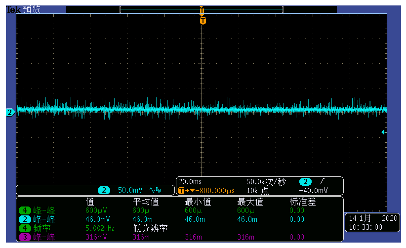

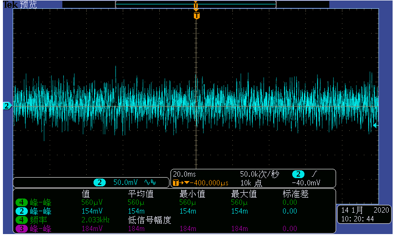

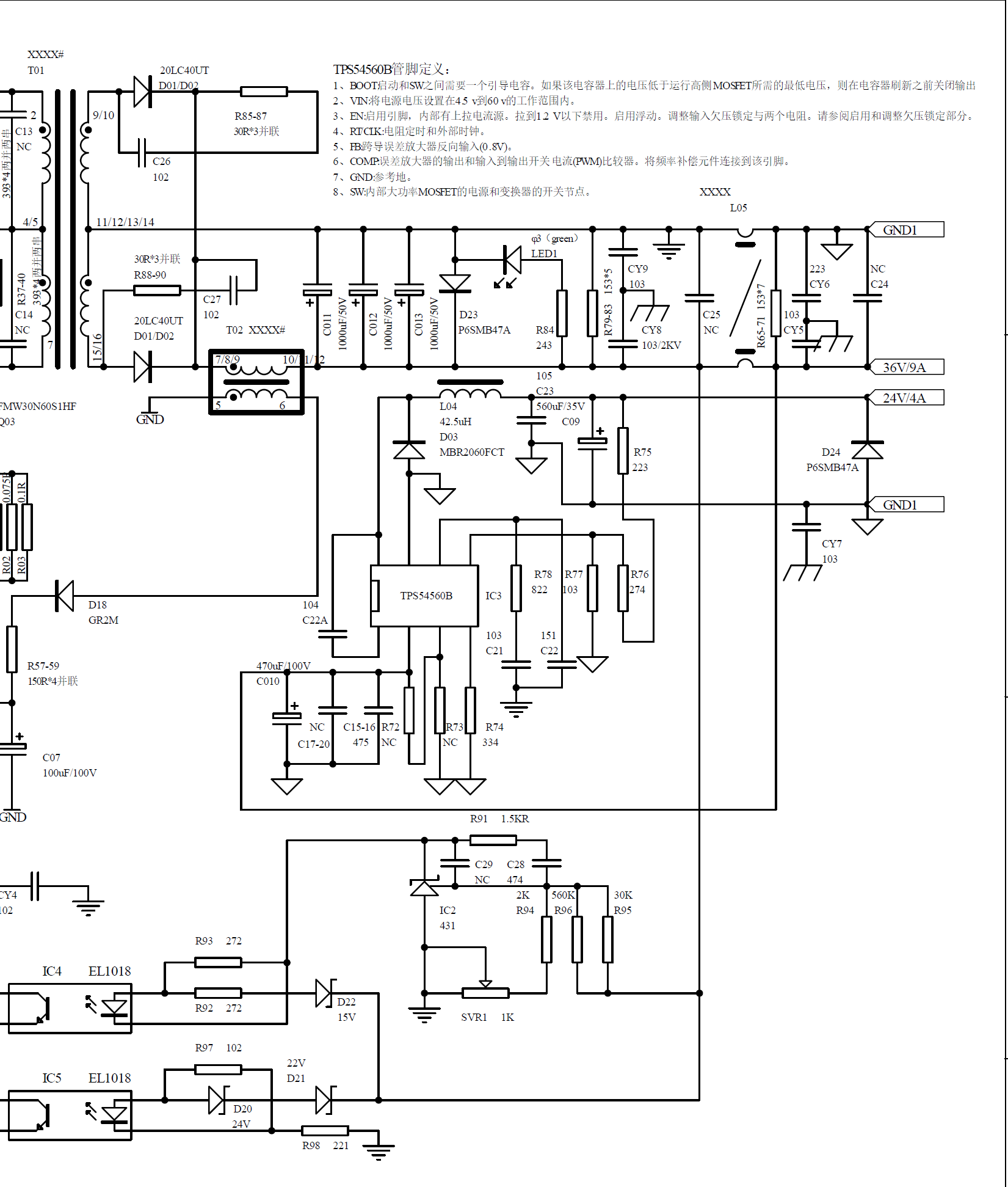

My customer's power product, using TPS54560B, found Vout ripple issue.
The spec is Vin:36V, Vo: 24V, Io: 4A
Have 10 boards with much larger ripple among 100 boards, 150mV~200mV ripple. But the normal ripple is 50mV.
the design & board & external components are exactly the same, and related pics are as below, pls give some suggestion.
  • Hi Lin,
    Pls download circuit calculator for TPS54X60 on TI website to calculate external components.
    I assume ESR is about 60 mohm for Cout C09 560uF 35V:
    R278=8.06K, C21=0.47uF, C22=4.7nF
    Pls try if it improve output ripple.
    C15-16 MUST be assembled, place 0.1uF 100V cap close to VIN pin and  D03 GND.
