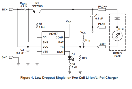

I am evaluating the circuit of datasheet P.7 (Figure 1.) with power IC and MCU.
Power IC is for MCU(+3.3V),  it is connected to Li+ and MCU is to control.
I observed the phenomenon listed below.
Could you please advise.
Supply 5V to DC +,
Charge a lithium ion battery (3.6V nominal voltage) by using BQ2057CTS.
Next, when the 5V supply is removed, current flows from the lithium-ion battery in the opposite direction of Q1.
(Current flows from the collector of Q1 toward the emitter of Q1. At this time, VCE is about 1.0V.)
As a result, 2.5V to 3.0V voltage is applied to VCC of BQ2057CTS.
(1)Is there no problem if reverse current flows through transistor Q1?
(2) When 5V is not supplied to DC+, the VCC of BQ2057CTS has a voltage of 2.5V to 3.0V.
→ Is this VCC necessary for operation for BQ2057CTS?

  • Hi Shinichi
    During an off or no input power state the CC pin to Q1 base is high impedance.  This could possibly increase the leakage current thru the device.  A couple of things to look at, lower leakage current transistor or high value resistor B to E.  Also diode on input to circuit to block reverse current.
    The BQ24040 or BQ24090 leakage current in this condition will be no greater than 1uA in this condition with no external parts added.
