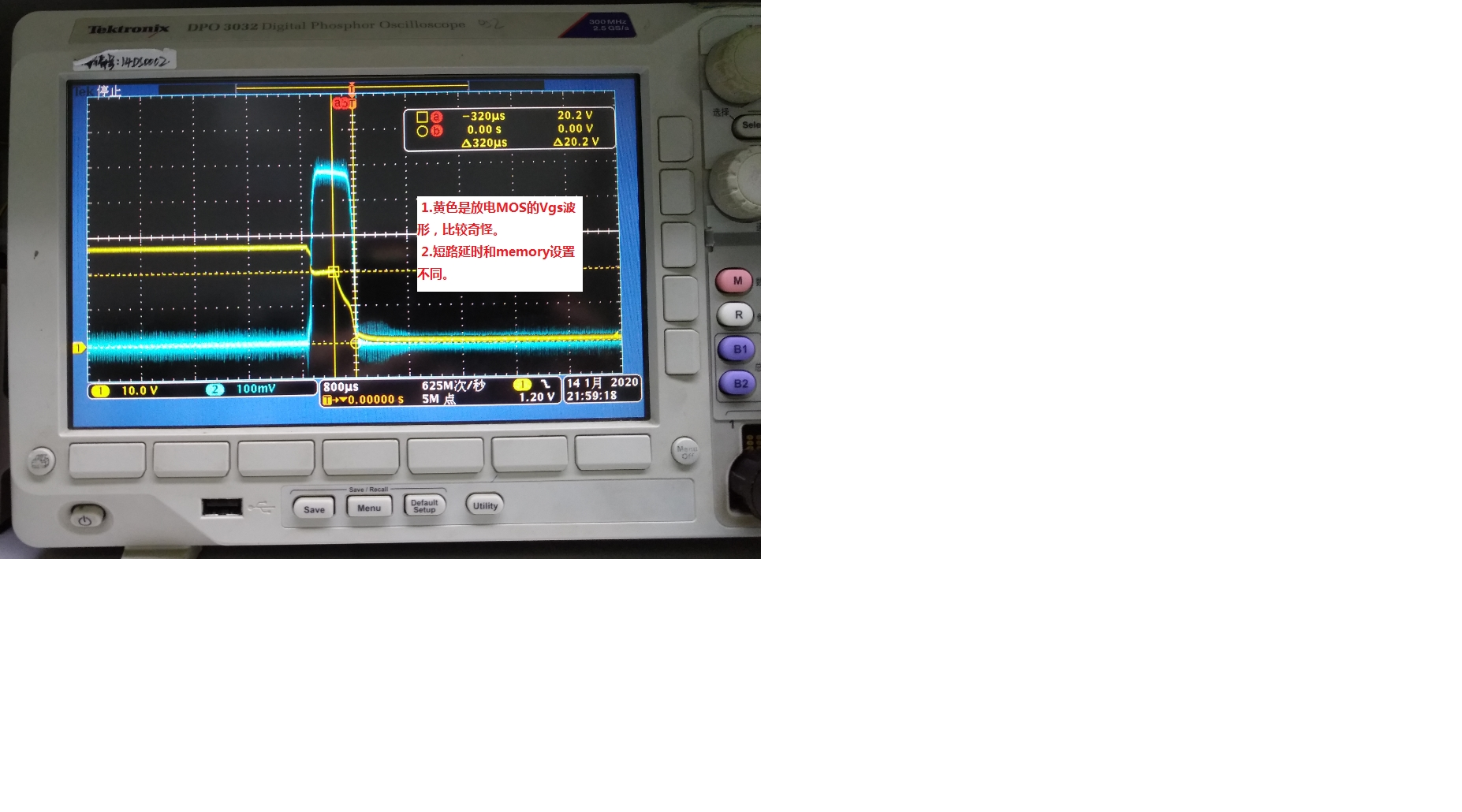

BQ4050 short circuit delay time is exceeds the range defined in the specification. For example we set 320us, but the actual test is 800us, external short circuit resistance is 70mΩ. The short circuit wave as below:
