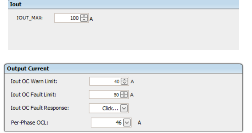

Hi Team,
What's the relationship between IOUT_MAX and Output current in protection table?
Do you have a guider for setting them?
Thanks a lot.

Hi Oliver, in this device, the OC Fault Limit will be set to 1.25x IOUT_MAX by default. If this is an SVID application IOUT_MAX will also be the IccMax limit.
