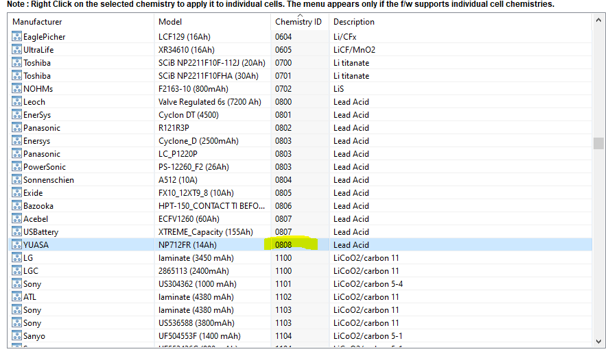

  • Hello Yevgen,
    I have updated the gg.csv file and device to the recommended Chemistry 0808 (see attached)

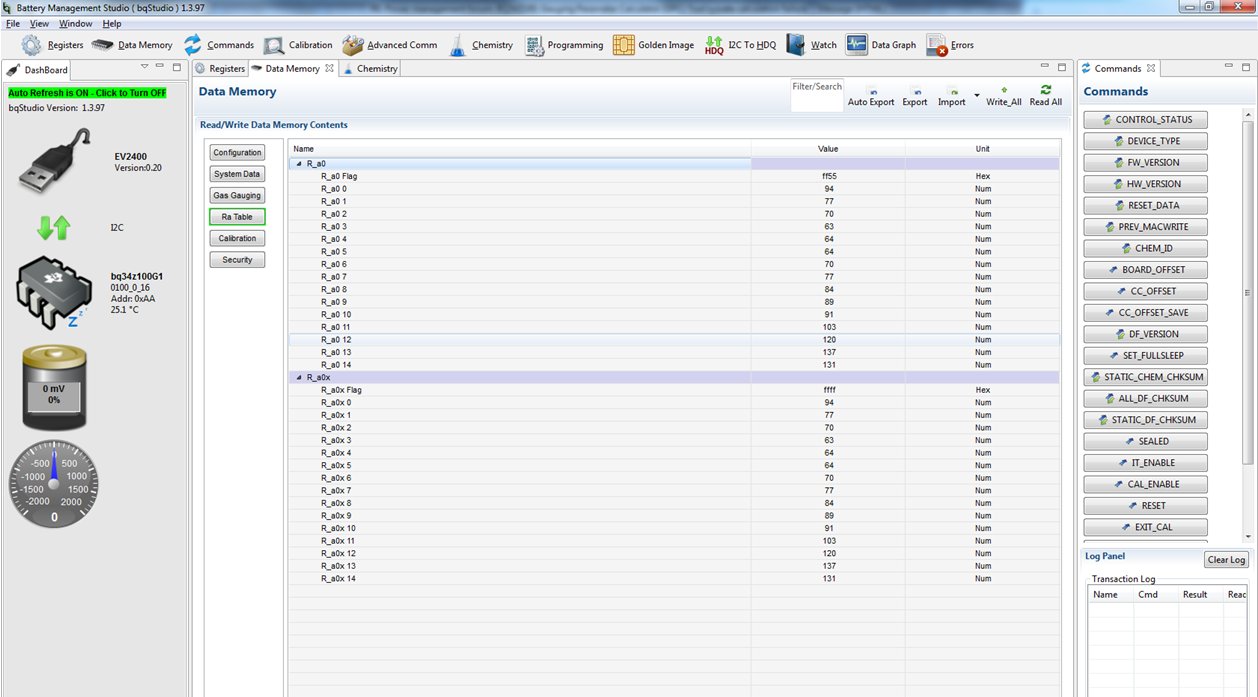

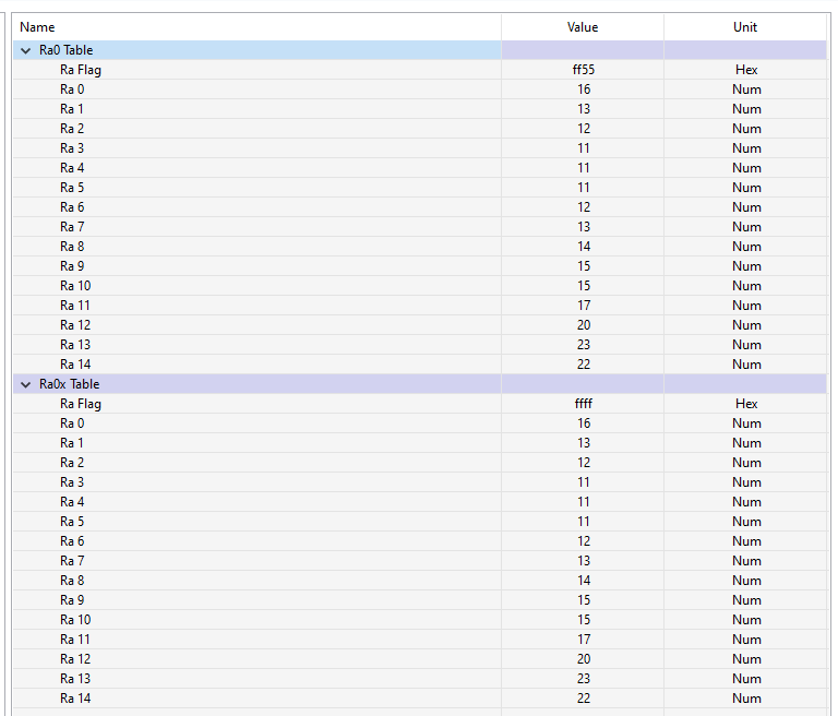

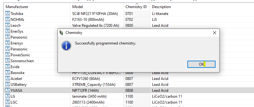

  • I just checked again.
    I selected the 0808 chemistry from the chemistry tab as shown below and successfully updated my device pressing "Update Chemistry from Database".
    Then I view the Ra tables by going to the data memory tab and clicking on Read All. My tables are updated to be as before.. not what you are suggesting:
    Ra Tables Ra0 Table Ra Flag ff55
    Ra Tables Ra0 Table Ra 0 16
    Ra Tables Ra0 Table Ra 1 13
    Ra Tables Ra0 Table Ra 2 12
    Ra Tables Ra0 Table Ra 3 11
    Ra Tables Ra0 Table Ra 4 11
    Ra Tables Ra0 Table Ra 5 11
    Ra Tables Ra0 Table Ra 6 12
    Ra Tables Ra0 Table Ra 7 13
    Ra Tables Ra0 Table Ra 8 14
    Ra Tables Ra0 Table Ra 9 15
    Ra Tables Ra0 Table Ra 10 15
    Ra Tables Ra0 Table Ra 11 17
    Ra Tables Ra0 Table Ra 12 20
    Ra Tables Ra0 Table Ra 13 23
    Ra Tables Ra0 Table Ra 14 22
  • We  programmed ChemID 0808 to bq34z100 v0.16 and got the following values,
    which coincide with defaults.
    This is with the bqStudio 1.3.97 and Chemistry version 759
    What version are you using for both bq34z100 and bqstudio?
    What chemistry updater version do you have?
  • Thank you, I had an older version of chemistry profiles loaded.
    I now have the correct impedance tables.
    I will retry and let you know if this solved the issue.
