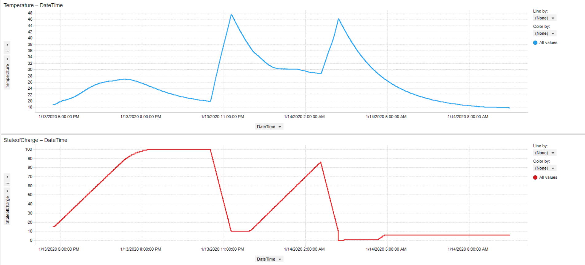

                      My pack is 10S4P(36V/13Ah) which is using BQ34Z100-G1 gas gauge. Recently I met a problem that has been bothering me for a long time. I need your team's help. Below is the problem details.
 The pack discharging to 10% SOC with 14.2A,stop discharging, then rest about 30 seconds. SOC will jump from 10% to 0% although I disable the RELAX_JUMP_OK. the jump only occurs when the SOC ≤10%. sometimes occur jump, not always.
Does TI have any suggestions for RELAX_JUMP_OK? Should we disable it?
attach the gg file and logging datas.SOC jump from 10 to 0.zip
