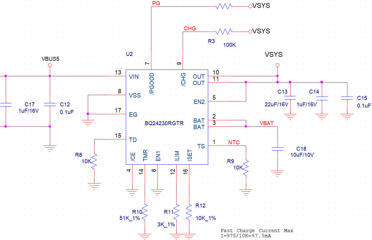

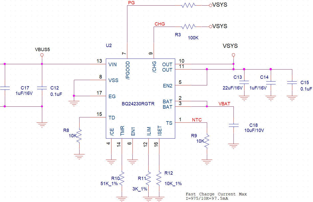

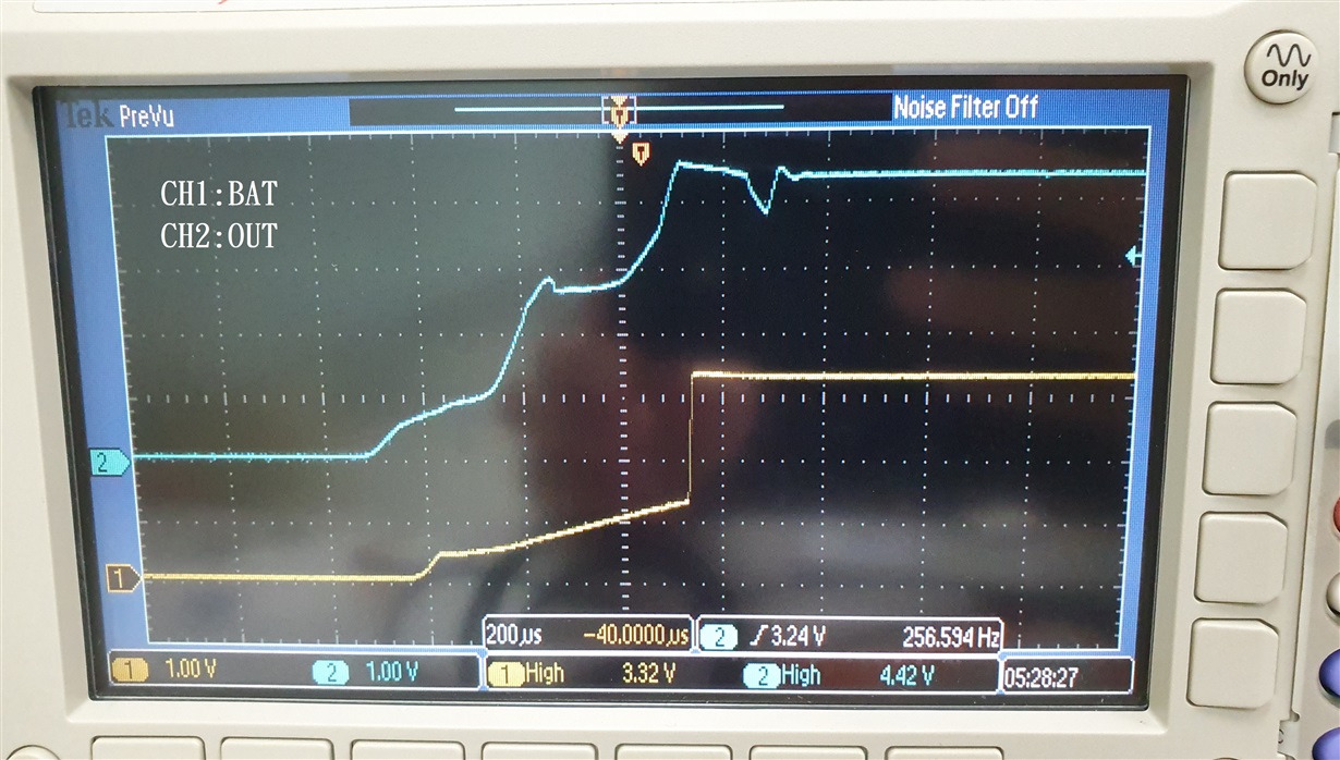

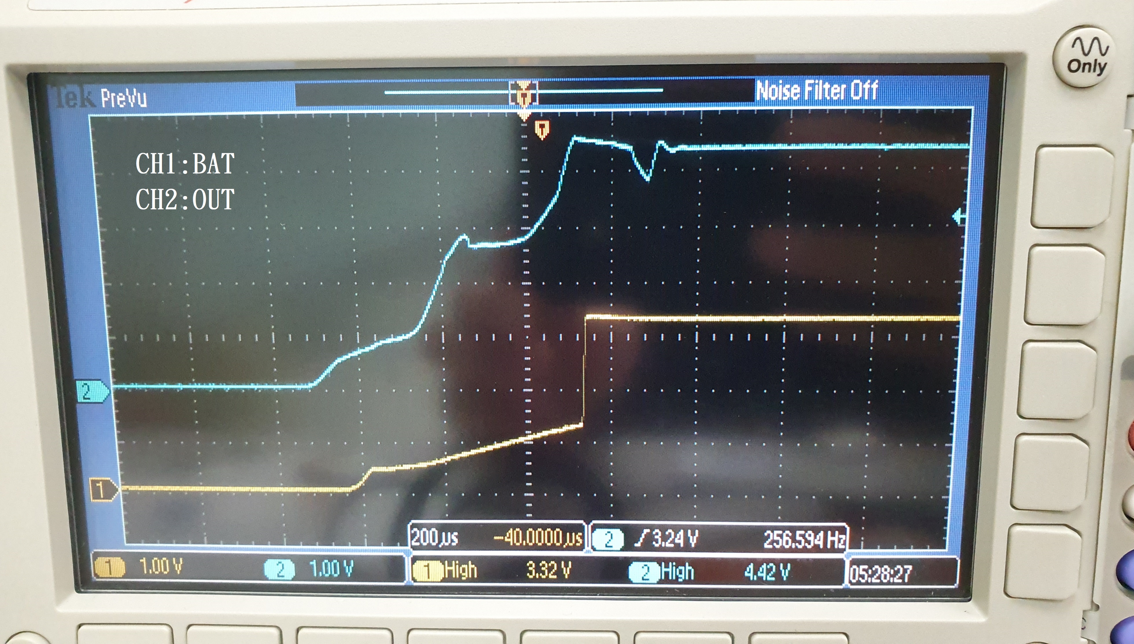

Dear Sir:
When system run out of battery, then I plug  5V power adapter for power on our system , but our system can't work fine. ... (The battery is charging now and  Out 4.4v)
It seems that DPPM function issue.....The following picture is our schematic for your reference.
