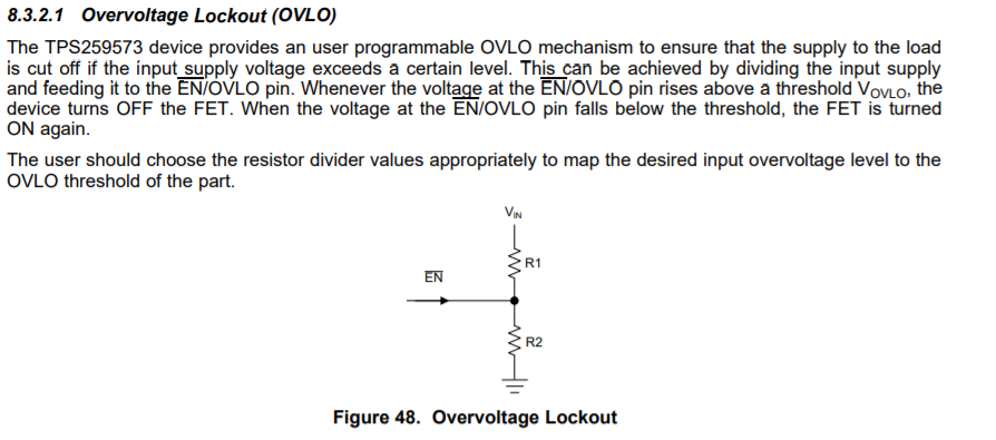

We know TPS259573 OCP setting by 2 resistors divider, but how to calculate it?
ex: if want st to 3.8V, how to use R1 and R2?
Thanks, Ian.
