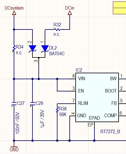

Issue: If there is no battery pack connected, the system voltage (Vsys in the EVM schematic) will not always turn on. Same happens if the battery pack is completely empty. Our workaround is to feed DC in directly to our DC/DC for the MCU:
Question 1: Works fine, but I'd like to understand why the bq24773 won't work without battery pack. Should it work?

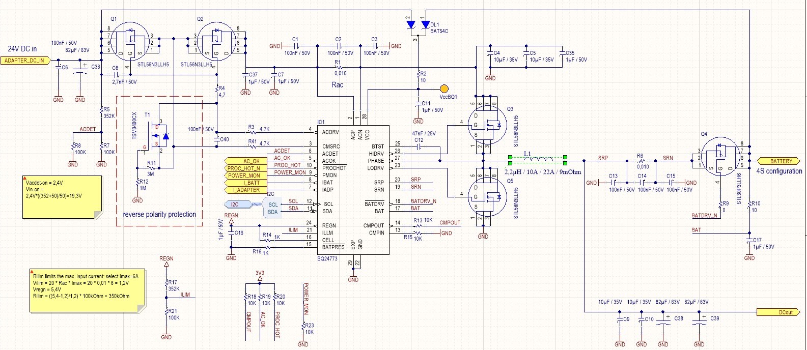

Tuning. For our prototype we used STN56N3LLH5 (N-channel 30 V, 0.0076 Ω typ., 56 A, 6.5nC, Vgsth 2.5V) and STL30P3LLH6  (P-channel 30 V, 0.024 Ω typ., 9 A), inductor is Würth 74437358022 (2,2µH / 10A / 22A / 9mOhm). I want to replace those three components on the next board. Here is the current schematic:
I assume that Q1, Q2 and Q4 are used as switches only, so I'd replace them with MOSFETs with a very low Rdson. For the P-MOSFET maybe a type which can handle a higher current if I want to upgrade to 8A.
I forgot the 10uF on the battery side (C23 in the EVM) that was added as a fix on the board.
Question 2: For Q3 and Q5 I'd choose a MOSFET with a low gate charge first, then a low Rdson next. Is that correct?

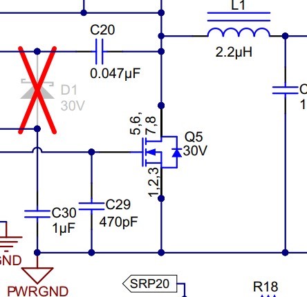

Question 3:The EVM scematic has 470pF (C29) on the gate of the low side FET. Why? The schematic in the datasheet does not mention this capacitor.

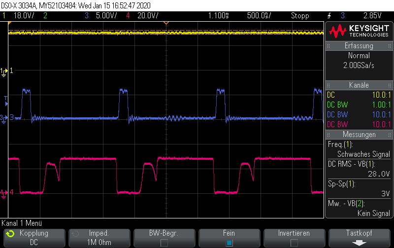

These are the two gate drive signals:
Channel 1: battery current, channel 3: low side mosfet gate drive (LODRV), channel 4: high side mosfet gate drive (HIDRV).
Question 5: Why does the HIDRV signal have this dip? Is it expected? Does is afftect the efficiency? Is my BTST capacitor too small?

    For 1) It should work without the battery attached. The system voltage should be regulated regardless of the battery voltage. Also your image does not appear. Can you repost it?
    For 2) Your schematic does not appear in the thread. Can you repost it? Without it, I can't tell which FETs Q3 and Q5 are. If they are LSFET in the buck converter, I would focus on the RDSon because of how high your currents are. The conduction losses will take precedence at higher currents.
    For 3) Without seeing what is attached (you will need to repost all of your images, waveforms, schematics as they did not appear), I assume these are the holding caps on the LSFET. The 470pF on the LSFET is to help prevent a false turn-on of the LSFET during the HSFET turn-on due to the Cgd. We artificially increase Cgs to hold onto the gate.
    For 4) The part number says BQ24733; but you are referring to the BQ24773, correct? Adding resistors to HIDRV and LODRV will make the power loss higher because you effectively reduce the turn-on and turn-off time of the HSFET. This will increase your switching losses. Consider a parallel Schottkey rectifier diode from GND to SW to improve the reverse recover loss, and also consider paralleling HSFETs and LSFETs and finding an even lower DCR inductor.
    For 5) I cannot see the waveform.
    Is there a simple way to estimate losses (soemthing besides creating a simulation)?
    Ok, I'll add that one. Is the actual capacity of the capacitor critical?
    The capacitor of the capacitor is typically there to make the total effective Cgs capacitance about 1.5-2x higher than the Cgd capacitance. This is more important in FETs where Cgd and Cgs are relatively similar in magnitude.
