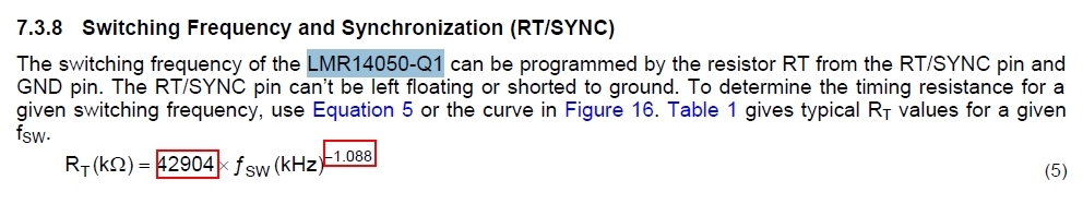

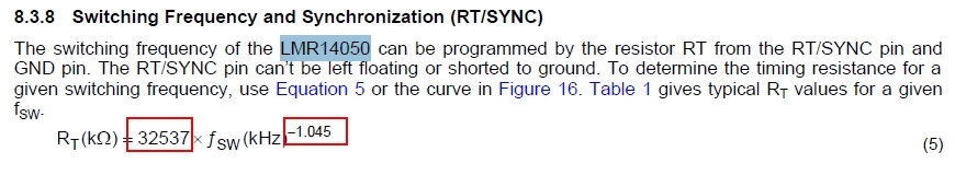

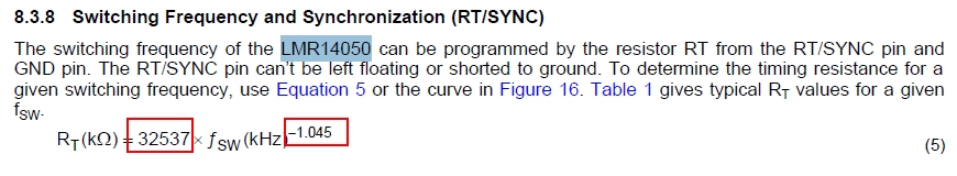

Hi team,
Why the switching frequency setting for LMR14050-Q1 different with LMR14050?
