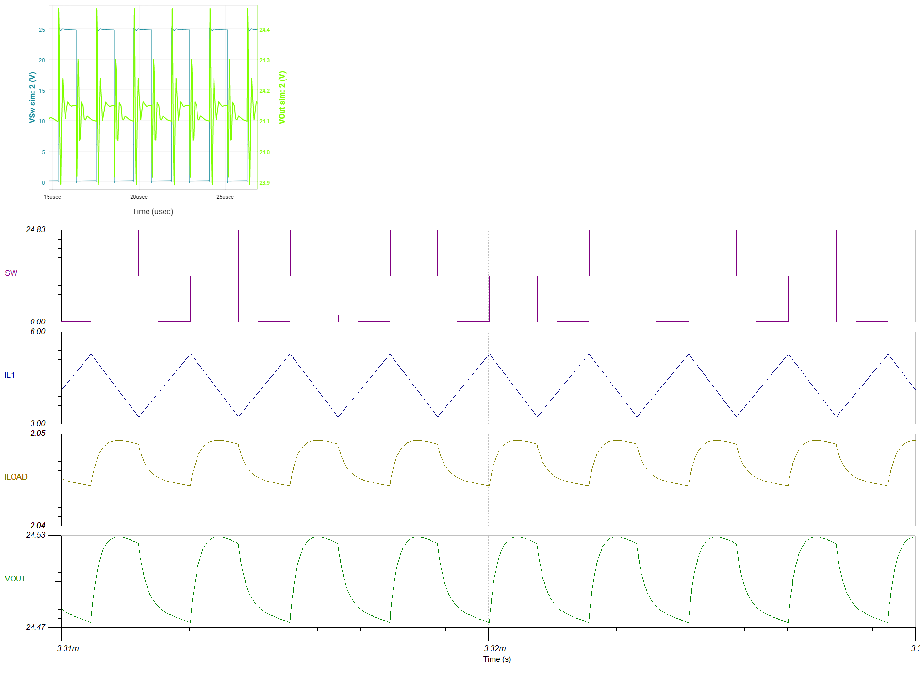

Also, I've done some steady state simulations with WEBENCH, where i got quite messy VOUT signals. On the other hand, results of VOUT in TINA-TI seems too good to me. Could it be that WEBENCH' elements have more parasitic "variables" evaluated in them? I'm attaching snips of sim's below.

    Regarding your simulations, seemingly the Webench take into account the parasitics especially in the FET and rectifier diode models.  The sim models can help you to get a good start point in your design, and also some quick visualization of your design operation.  However, please always verify and fine tune the design by experiment.

    Regarding your below query on WEBENCH simulation results,
    "Also, I've done some steady state simulations with WEBENCH, where i got quite messy VOUT signals. On the other hand, results of VOUT in TINA-TI seems too good to me. Could it be that WEBENCH' elements have more parasitic "variables" evaluated in them?"
    WEBENCH uses relatively more realistic Cout SPICE model than standalone TINA-TI model. The spikes in Vout is usually observed if the Cout model assumes ESL (Equivalent Series Inductance).
    However the standalone TINA-TI model doesn't assume ESL. Hence we are obtaining clean results in TINA-TI.

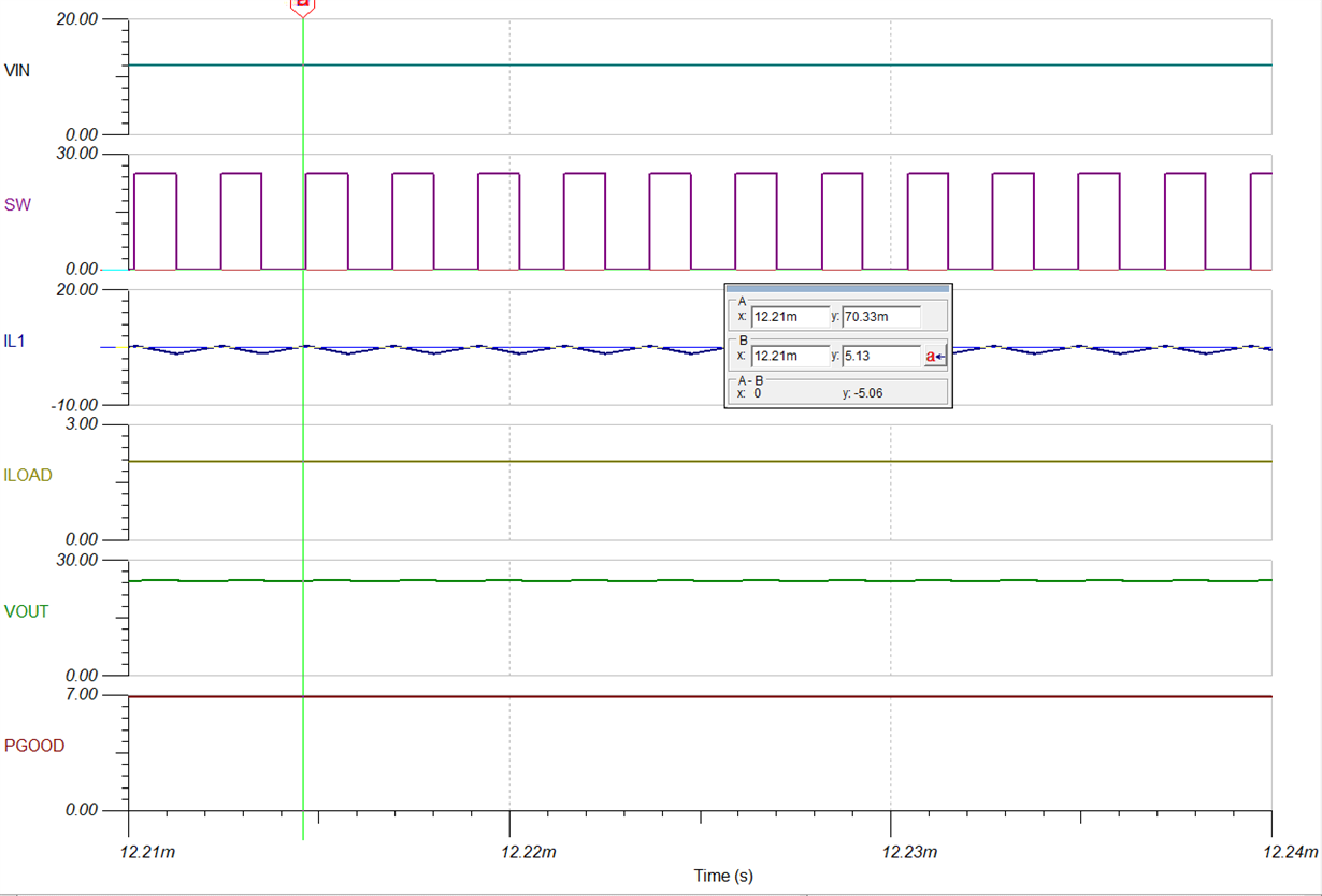

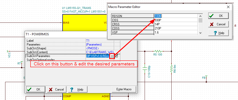

    I tried changing the Rdson parameter. It got properly reflected even in simulation results. Follow below steps to change the MOSFET parameters.
    I changed Rdson from 5.7m Ohm to 100m Ohm
    Below are the simulation results with Rdson=5.7m Ohm. The voltage at SW node is 70.33m [= Inductor Current * (Rdson + R6)]
    where Inductor current is 5.13A as shown in below snapshot, R6=8m Ohm (resistor in series with MOSFET)

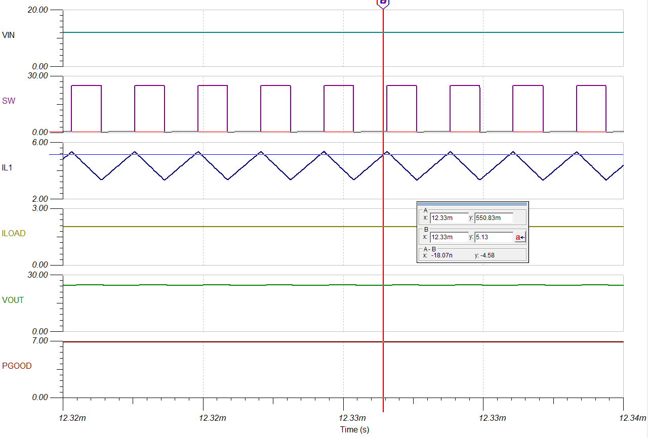

    Below are the simulation results with Rdson=100m Ohm. The voltage at SW node is 550.83m [= 5.13 * (100m + 8m)]
    Thus it can be concluded that FET parameters are getting properly reflected. Kindly let us know in case you have any further queries.
