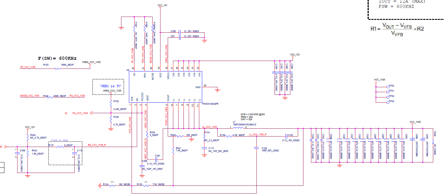

I find it will be weird to use the currently equation on the datasheet to calculate the OCP value.
Base on the currently equation will get OCP=2.9A.
Can you check on it?

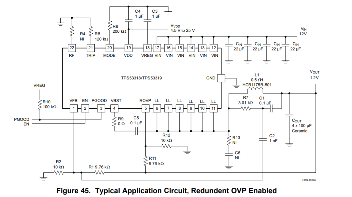

Or you can also check what is the below circuit OCP value, appreciated.
I also double-check the OCP value on our datasheet
Use the previous equation will get OCP=11.9A, which is make sense
