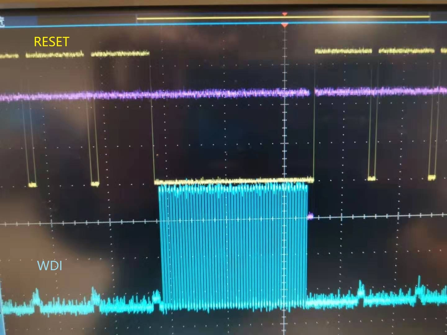

My customer reports a problem with TPS3828's watchdog function. Unlike typical application, customer use this device in a special way: the WDI input is driven by a specific circuit during some specific time to disable the watchdog timer in some condition. So WDI input can be toggled even during /RESET active. The issue is they found the /RESET signal cannot be released if WDI input is pulsed with period of 50ms (50% duty cycle). Below is the screen shot of test waveform. I am wondered if the duration of the WDI transition MUST longer than delay time?
