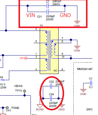

Hi, team.
What is the role of EVM C7 and C31?
Are they necessary parts?
Hello Hirotsugu,
This capacitor suppresses EMI by providing a return path for noise that is coupled across the flyback transformer.
I have never seen a design without them.
If this post answers your question, please indicate so by marking this thread as resolved. Thank you.
Michael P.
Applications Engineer
Texas Instruments
It is a low pass filter that helps with EMI. What is your question?
