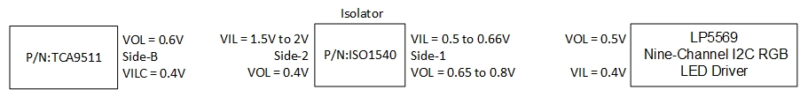

  • Since we are having two buffers before TCA9511 the Low-level voltage is offset three times and we don't have control over pull-up of the buffers. hence we are planning to break the chain by the added isolator. the Isolator VCC1&2 are the same 5V rails and GND1&2 are the same ground.
    The VIL and VOl level ISO1540 and LP5569 are not compatible however the ISO1540 an open drain, in that case, if we use a proper pull-up we could have control over the Low-level voltage.
    Please review and share your comments.
  • Hi Thiagarajan,
    I would not recommend the solution using ISO1540. The Vol of this device mis-matches with LP5569 in a similar way to the origial problem with TCA9511 to LP5569. I do not have a simple solution to suggest right now. We don't have any buffers that would be compatible with these thresholds that works at 5V Vcc. I am going to gather more information on LP5569 to see what work-arounds may be possible before suggesting something too complex. I will give you an update within the next couple of days.

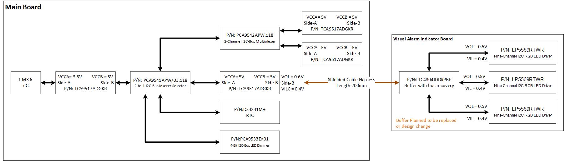

    Correction a typing error, we are using P/N:TCA9517ADGKR on the mainboard. We are open for BOM Level changes on Mainboard and we have 4.7K pull-up on B-Side of TCA9517.
    The Visual alarm indicator is on the prototype stage, we are open for any change to use LP5569. Mainboard sources 5V to Visual alarm indicator PCBA.
  • Hi Thiagarajan,
    Thanks for the update and figure. We're looking in to possible BOM changes that would allow everything to remain within spec. It's possible we may have to suggest a more complex work-around than the buffer we were hoping for.

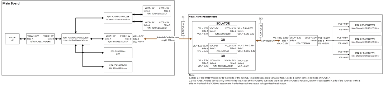

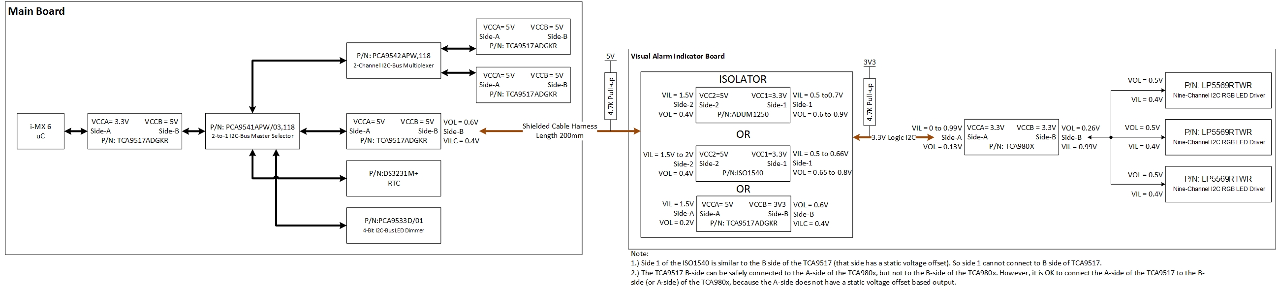

  • Hi Eric,
    Thanks for your reply. I have tried below options and tested options of ADUM1250 and TCA9517 and found them working. I am going to try ISO1540 options tomorrow.
    Please review this approach and share your suggestions. Also, we are still interested on your suggestion to fix after discussion with the LP5569 team.
  • Hi Eric,
    we have tested all three options (ADUM1250m ISO154 & TCA9517) and they are all working.
    Please review this approach and share your suggestions. Also, we are still interested in your suggestion to fix after discussion with the LP5569 team.
