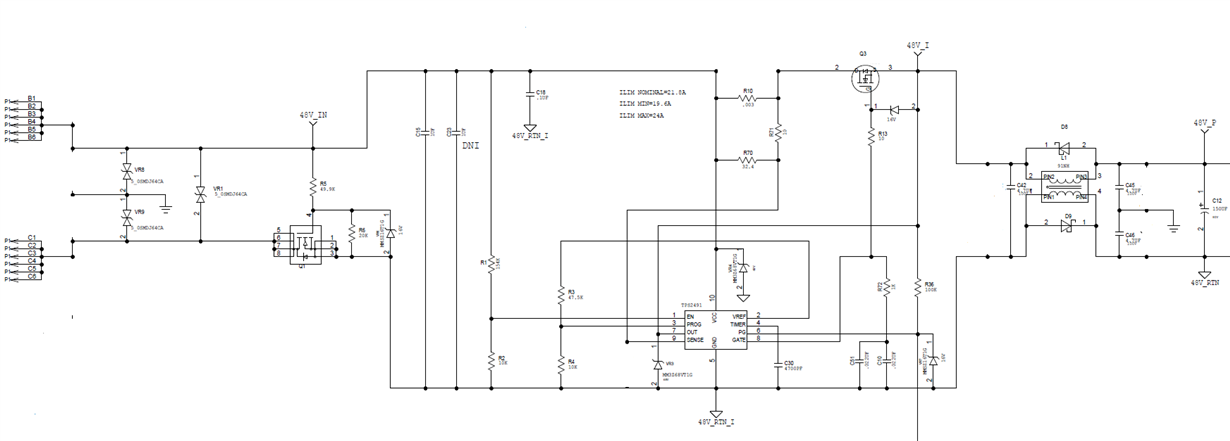

Using TI inrush limiter TPS2491 on my DC power board and carry-on DC surge test IEC61000-4-5 and found that output will momentary shutdown when surge voltage >600V(L/N) . Our requirement is need to pass(without reset) up to 1kV DC surge. I think it hit some protection mode and output momentary off.
  • Hi Keong, During surge test, the fast rising transient voltages generate huge transient current from input to output. This would trigger fast current trip and shuts down the device. Can you share your application and end equipment? Is it acceptable to use protection on the return path? Best regards, Rakesh

  • HI Rakesh,
    Thx for your explanation. My end equipment is connected to a digital/RF board.
    I have tested with either this board alone or connected to end equipment, both will have output shutdown issue.
    Do you mean add a diode on the 48V_RTN_I to TPS2491 gnd pin for protection?
    FYI, surge test have cover polarity +ve and -ve, both i found output will shutdown.

  • Hi Rakesh,
       Design max load ~15A. Efuse not suitable for my application.
    FYI, previous revision PCB don't have surge issue but this new spin PCB have. On new PCB, TPS2491 have location change and big layout change. But all component value remain same.
    So from your explanation, during surge, huge current flow thru sense resistor to charge the output cap and trigger OCP.
    I still figure out how to minor tweak to solve this issue as no layout change allow.
  • Hi Keong,
    Ok.
    Yes, surge can trigger OCP. To overcome this, you can add small filter across Rsense as shown in Figure-11 in http://www.ti.com/lit/an/slva703/slva703.pdf
