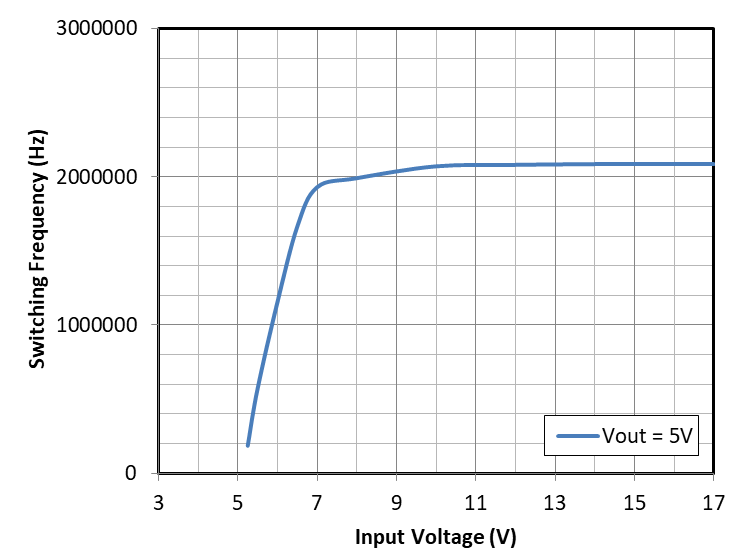

TPS82130: Switching Frequency
Part Number: TPS82130
Hi
My customer has question.
Is there a graph for Vout = 5V for Figure22 described in the TPS82130 data sheet?
Regard
T Kishi
