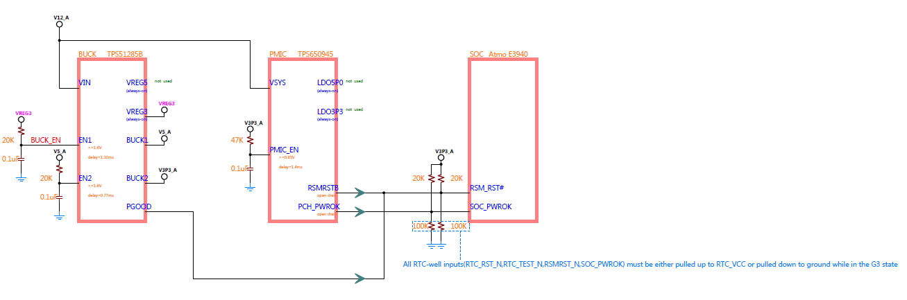

Dear Sir, we are now using TPS51285B as BUCK, TPS650945 as PMIC and CPU is Intel APL-I E3940.
When we shutdown the board in Windows 10 OS, the 5V and 3.3V output of TPS51285B are shutdown also.We notice that there is no communication interface between TPS51285B and CPU. How does this work?
