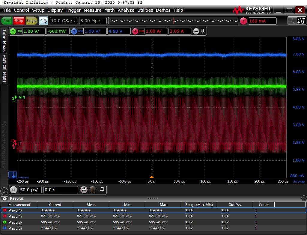

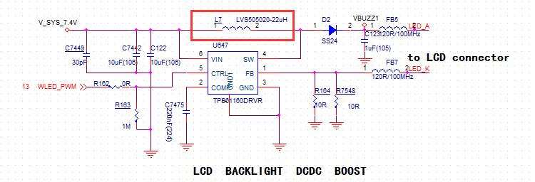

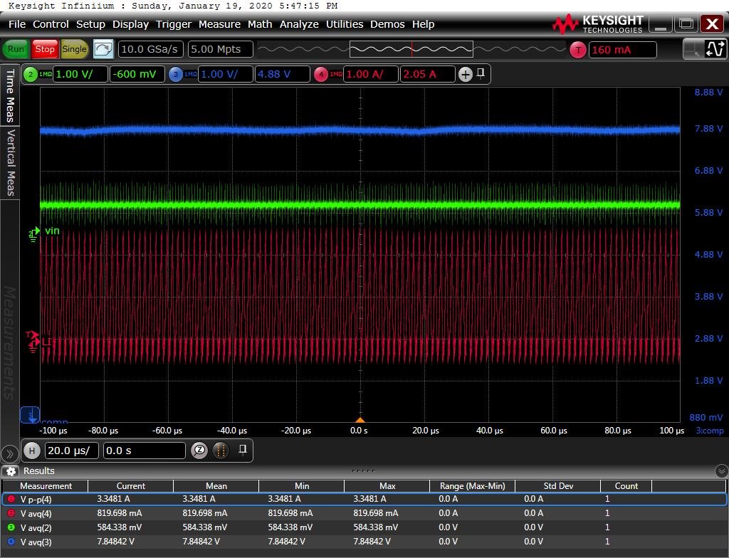

The inductance L7 has a sound. The customer has a question about it.
1.Is this normal?
2.Is there a way to correct it?
Hi Kevin,
Is the output current equal to the designed value? Or you can try with a higher saturation value inductor?
Sean
Hi Sir,
Increase the supply voltage that may help or you can choose TPS61165.
Sean
