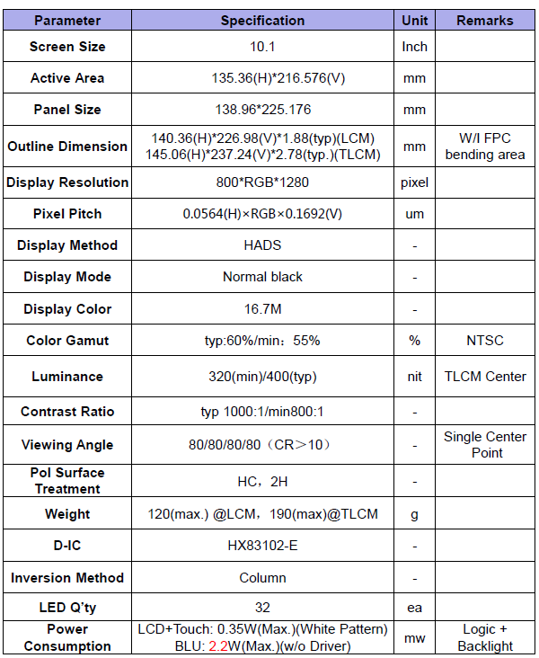

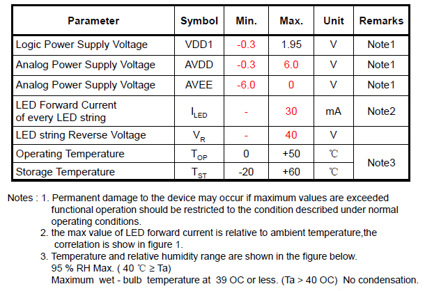

Here's the spec of my panel, can you help suggest TI solution for back light driver and bias power ?
