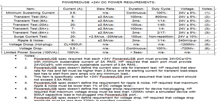

    40A is just a inrush peak current, it is the test item of Hot-plug as below.
    If I set the OCP to 40A, the value of current shunt will be very low. However, the system working the output current is only 3.5A, the voltage of pin7(ISNS) will also be low. Did the ISNS has the lowest tigger voltage? I am worry about that ISNS is too low, so there will be no PWM signal.

    The TPS40210 cannot control the initial inrush current to the output capacitor when the input voltage is initially applied. The diode in the power drain will conduct and the inrush current is based on the resistance from input to output. If you need to control the inrush current then a device similar to the LM5060 should be used.
    The current sense resistor should be selected to accommodate the normal operating peak current, not the inrush current.
