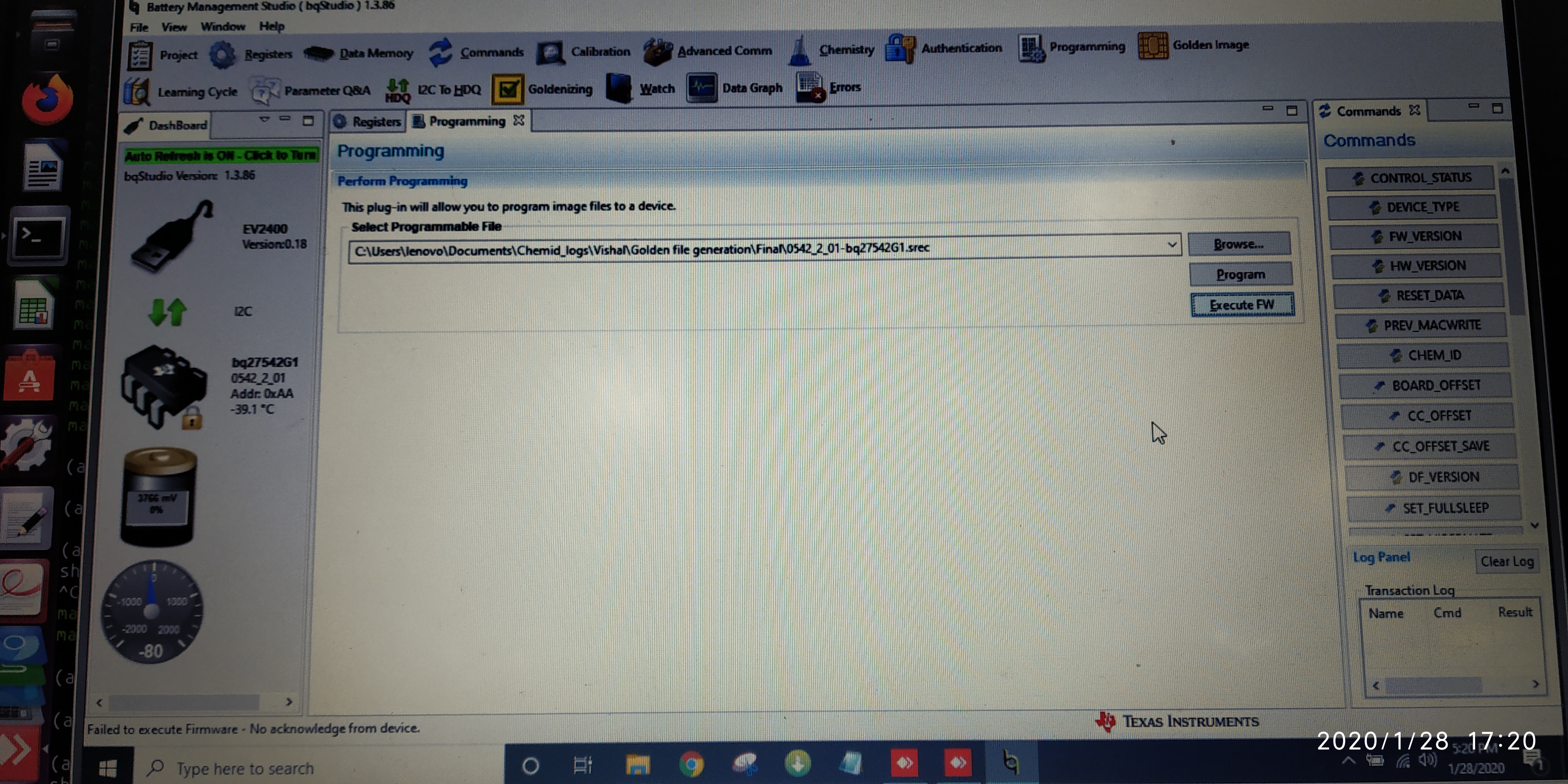

  • Hi Andy,
    We are dumping the golden image using the bqstudio. In the Programming Section, I selected the srec files and programmed it by clicking on the Program button. Then I clicked on Execute FW button, during which it throws me the error "No acknowledge from device". What could be wrong here ? Is it necessary to click on "Execute FW" button after successfully programming. I am attaching the screen shot for this.
    Mahek
  • Hi Mahek,
    Power off and then power on the gauge device. Relaunch the bqStudio and see whether bqStudio is still able to communicate the device that has been programmed.
    Andy
