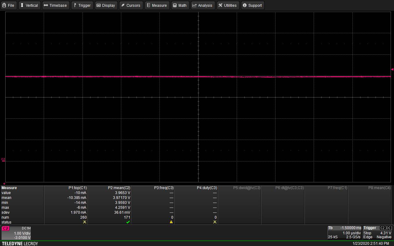

    the OTG pin is tie to ground through a 10K resistor.
    OTG bit on register 03 is untouch and should default to disable
    there is no waveform on the SW node. only a DC voltage from the battery. Note that this measurement is with the charger NOT connected.

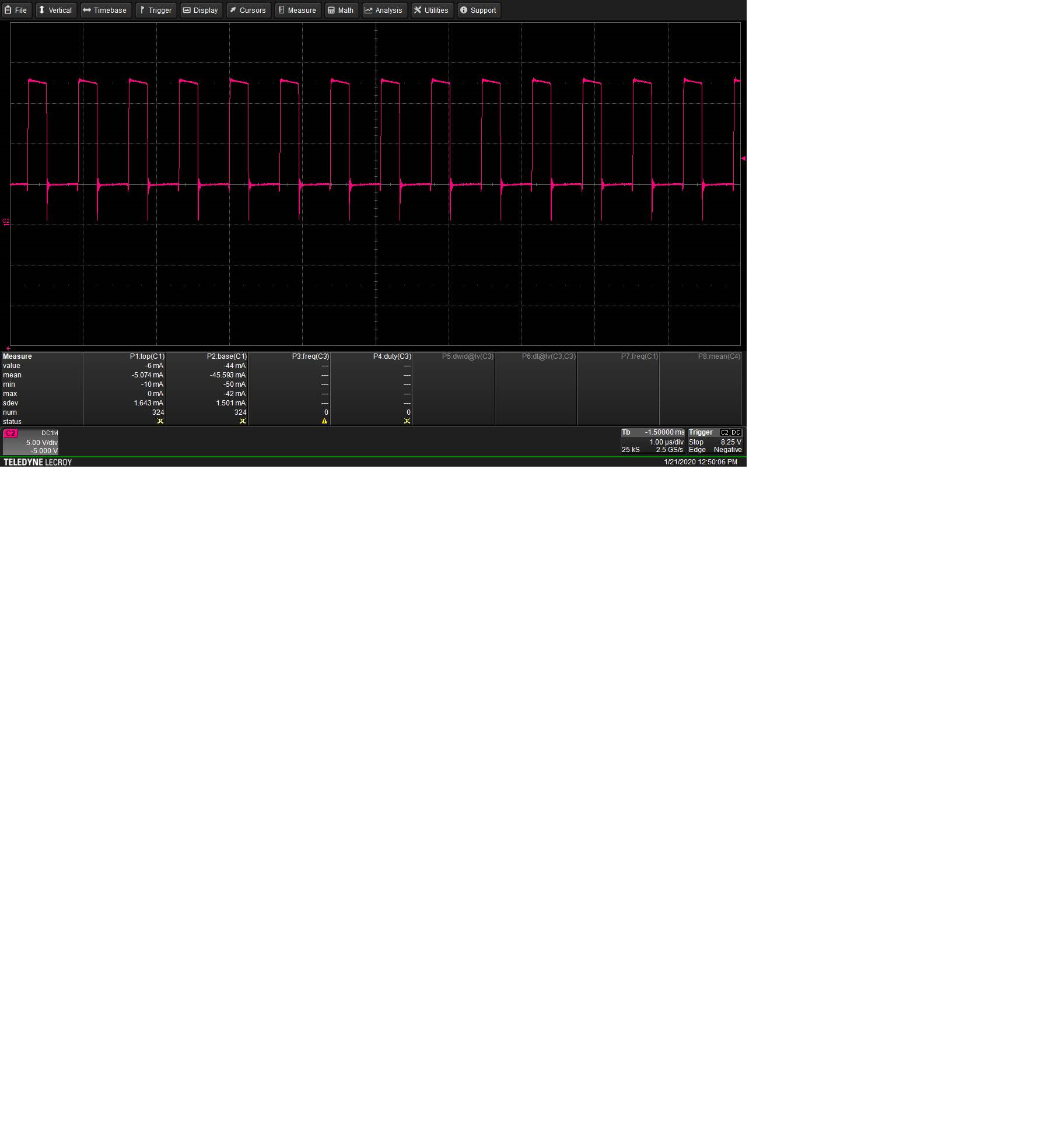

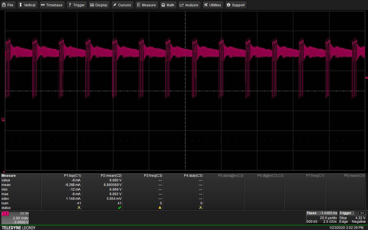

  • Hi Jeff,
    when the charger is plugged in, we do have a square wave. please see attached for picture.
    thanks

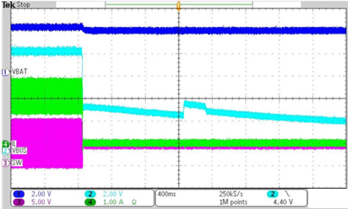

  • Henry,
    The following info would be helpful:
    1. When "the device input voltage is still present even after charger input is removed", please take VBUS, SW, VBAT and I_inductor waveforms. I_inductor gives idea about the load condition when charger input is removed.
    2. What is the operating charger input voltage before it is removed?
    3. Actual VINDPM threshold. Related registers are REG0D AND REG01[0].
    Ning.

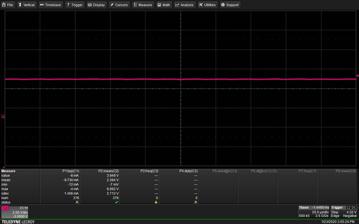

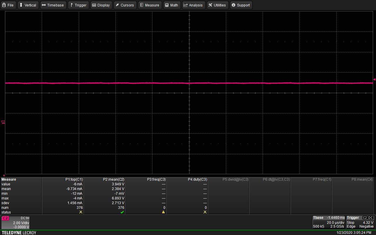

  • Hi Ning,
    1) please find the captures of VBUS, VBAT, VSYS, and SW node.
    2) the input charger voltage is 12V
    3) we have implemented VINDPM to set the input range to be at 5V which is higher than the VBAT, we are still getting the same fault.
    Here are the images with charger removed:
    Fig 1. SW node with charger removed
    SW node with Charger Unplugged
    Fig. 2 VBAT with charger removed
    VBUS with Charger Unplugged
    Fig.3 VBUS with charger removed
    Fig 4. VSYS with charger removed
    let me know if you want images with charger plugged in.
    thanks
    Henry

  • Hi Hank,
    If the charger is switching with battery only and OTG is turned off, then it is boosting back to the input (unintentional OTG).  We have seen this before with very high (>100 ohm) series resistance with BTST that was due to poor layout but never with only 10 ohm series resistor to reduce EMI.  Also, it is odd that changing VINDPM did not stop the boost back.  Since lowering the resistance stops the problem, I will assume this case is closed.
  • Hi Ning,
    It is odd that only some devices behave this way with 10 ohms and some still OK with 24 ohms. So you are saying some of the devices in this lot is defective?
    I am not sure if this case is resolved yet. If we are to put the series resistor to 0 ohm, I am worried that EMI will be an issue as we put this series resistor to lower it in the first place.
    when you say boosting back(unintentional OTG), what exactly is this mean? can you explain it in more detail?
    thanks
    Henry
  • Hi Henry,
    If the buck converter is synchronous (low side FET instead of diode), there is the possibly for negative inductor current to flow, even when operating in buck mode.  When you connect a synchronous buck converter in reverse (i.e. a power source at the output and floating or load at the input), as a battery charger will be when no input power is applied, there is a risk of negative inductor current flowing back to the input, so called boosting back to the input.  With adapter applied at the input for buck mode, we add special circuitry to limit the reverse current flow to prevent boost back during buck mode.  Now, because the charger uses a high side NFET, instead of PFET, it needs the BTST 1/2 charge pump circuit to provide the drive voltage for the NFET.  At light load, the charger must force a refresh pulse to keep that BTST capacitor charged.  If the resistance in the BTST trace is too high, the refresh pulse occurs more frequently.   With no resistive load on PMID or VBUS to discharge their capacitors, the charger can set up a self sustained loop where VBUS stays higher than UVLO and the refresh pulse continues. The VINDPM threshold can usually be changed to prevent this from happening.  Apparently, your board's BTST trace resistance and lack of load on VBUS or PMID sets up  the "perfect storm" for boost back.  Is the trace from BTST pin to capacitor to SW highly resistive, even without the series resistor, or using single VIAs to connect through board layers?  Does adding a load (like 10kohm) on VBUS to pull VBUS below UVLO stop the boost back?
    Jeff

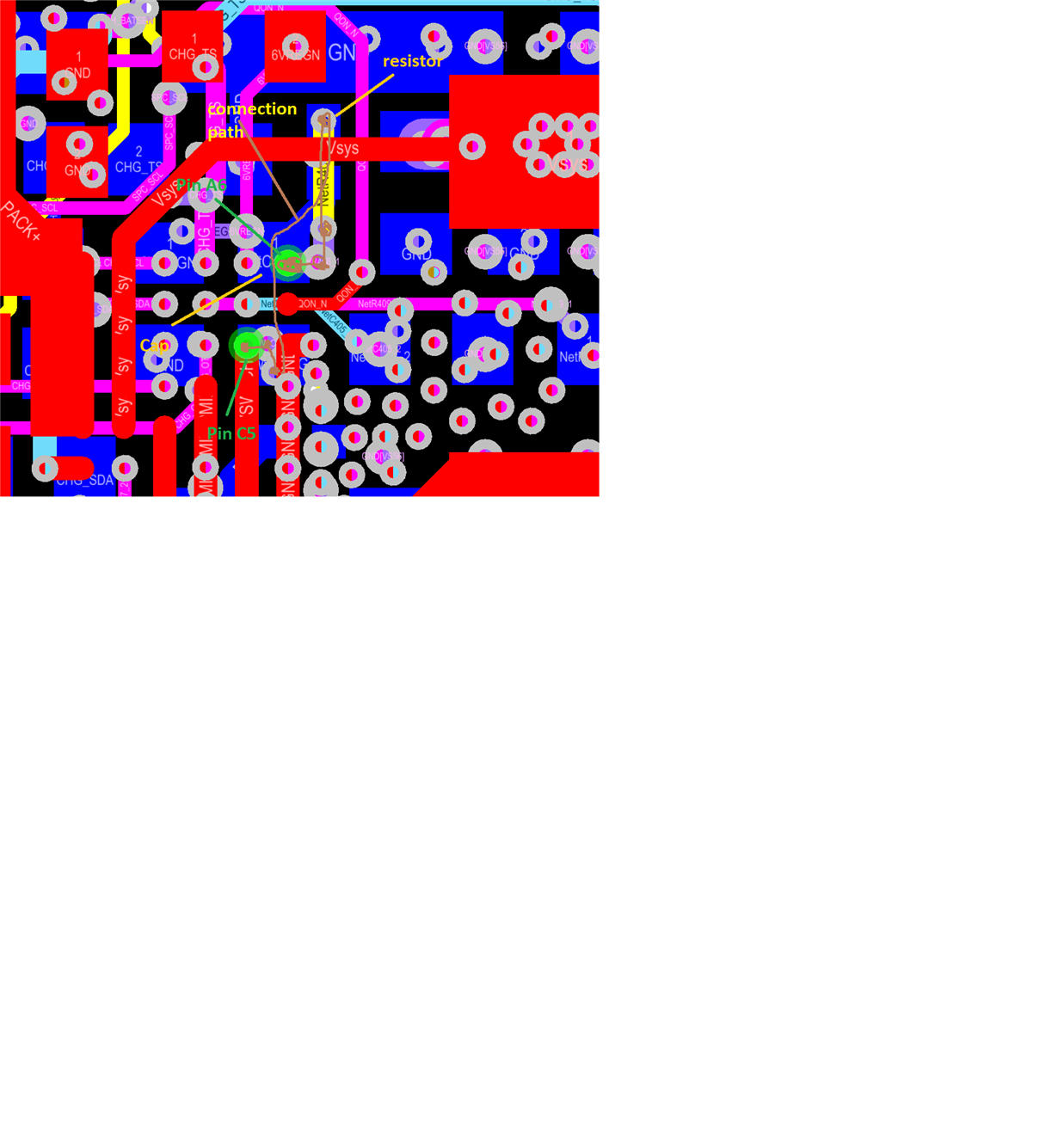

  • Hi Jeff,
    thanks for the explanation.
    -do you have a sense why most of the devices are OK even with a much higher resistor values then 10 ohms while some don't work at 10 ohms?
    -we did short the VBUS pin to ground to stop this problem although we didn't try 10k.
    -the connection SW and BTST is quite short with a relatively wide trace. see attach picture on the layout.
  • Hi Hank,
    You are only the 3rd customer of hundreds (who buy multi-millions of units) who have seen this issue with this product family.  Are you certain that the resistors installed were 10ohm and not 100 ohm or more?  The resistor trace appears to use single vias.  Via impedance varies greatly even on the same pcb.  Unfortunately, we have no way to test BTST impedance in production and do all of our validation without a series BTST resistor.
    Jeff
  • Hi Jeff,
    I am quite sure it is 10 ohms. yes the layout is using a single via. I can measure the resistance of this via. What is the maximum resistance tolerated?

  • Hi Henry,
    The max resistance hasn't been measured but based on experience with other devices using this topology and the other customer failures on this device, I would say <<20 ohm.
    The RBFET is controlled by comparators that compare battery voltage and VBUS voltage.  Because VBUS is staying above VBAT+80mV (sleep threshold) due to unintentional OTG, the RBFET stays on.
    Jeff

  • Henry,
    Please take VBUS, SW, VBAT and I_inductor waveforms as below when VBUS is removing and check at what VBUS voltage the device stops switching.
    Ning.

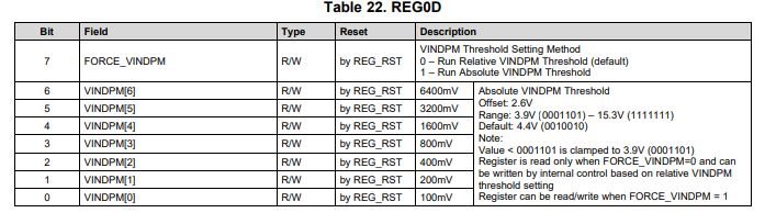

  • Henry,
    1. As mentioned earlier, setting VINDPM to the minimum 3.9V usually helps. i.e. set FORCE_VINDPM bit  (REG0D[7]) to 1 and REG0D[6:0]=0001101 (3.9V). Please read back REG0D to make sure 3.9V VINDPM is set correctly.
    2.  The BTST resistor is to simulate a leakage path. What's your BTST capacitor value and voltage rating? Is it high quality ceramic cap? The official EVM uses Murata GRM155R71E473KA88D, CAP, CERM, 0.047uF, 25V, +/-10%, X7R.

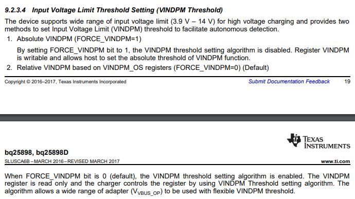

  • Henry,
    For VINDPM operation, please refer to 9.2.6.2 Dynamic Power Management and 9.2.3.4 Input Voltage Limit Threshold Setting (VINDPM Threshold) on the d/s for the details.
    To verify VINDPM threshold,
    1) Read back REG0D and it should be 10001101.
    2) Take VBUS, SW, VBAT and I_inductor waveforms when VBUS is removing as the sample waveform provided in the earlier response.
