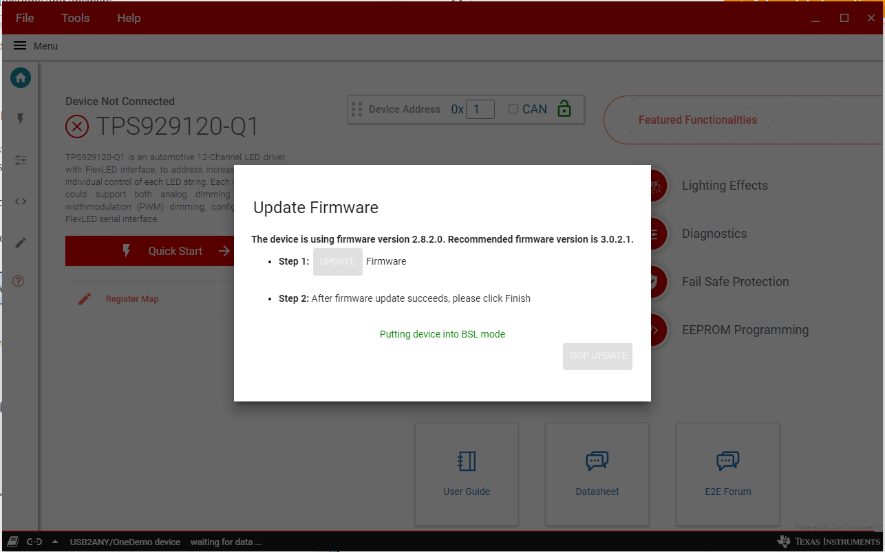

I have successfully installed TPS929120-Q1. My USB2ANY uses 2.8.2.0 version firmware
Now when starting TPS929120-Q1 I get message saying:
Update Firmware
The device is using firmware version 2.8.2.0. Recommended firmware version is 3.0.2.1.
  • Step 1: UPDATE Firmware
  • Step 2: After firmware update succeeds, please click Finish
At this point selecting SKIP UPDATE return to GUI but program doesn't connect.
When I select UPDATE a note saying:
Putting device into BSL mode
appears but nothing happens(actually some logical device is disconnected from system

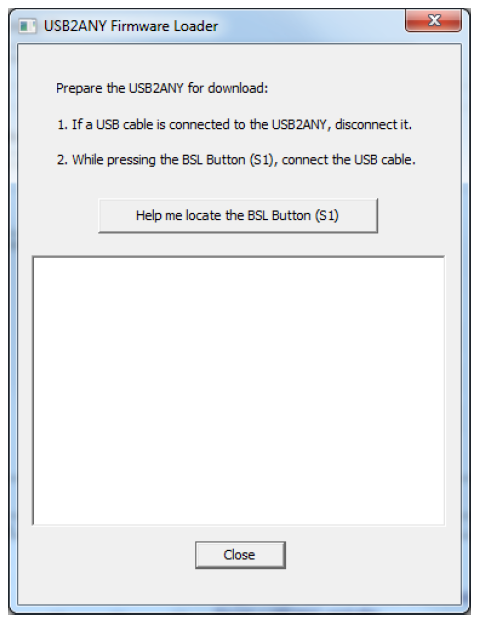

  • Hi Sefas,
    Thanks for your patience.
    From my understanding, you have downloaded the software “USB2ANY Explorer” to upload the firmware of USB2ANY to 2.8.2.0. And during the upgrade process, you have faced below prompt window that told you to press the BSL button (S1).
    If my understanding is correct, could you try to press the button again while seeing the note “Putting device into BSL mode”?
    If above step does not work, could you try different USB ports of your PC? It is very strange as we do not have face such issue before.

    Indeed, I have "USB2ANY Explorer"  SW to upgrade my USB2ANY devices to 2.8.2.0 firmware. And this works correctly.
    Issue is with TPS929120-Q1 SW. When I start TPS929120-Q1 it asks me to update firmware on my USB2ANY device to version 3.0.2.1. But when I select 'UPDATE' button I got "Putting device into BSL mode" message and it stays like this:
  • Here is screen TPS929120-Q1 is stuck.

  • Note doesn't go away for few hours.
    No difference if I press BSL button.
    No difference if I put USB2ANY into bootloader mode (press BSL button and then plug in USB)
    I tried stand alone TPS929120-Q1 as well as web client with similar results
