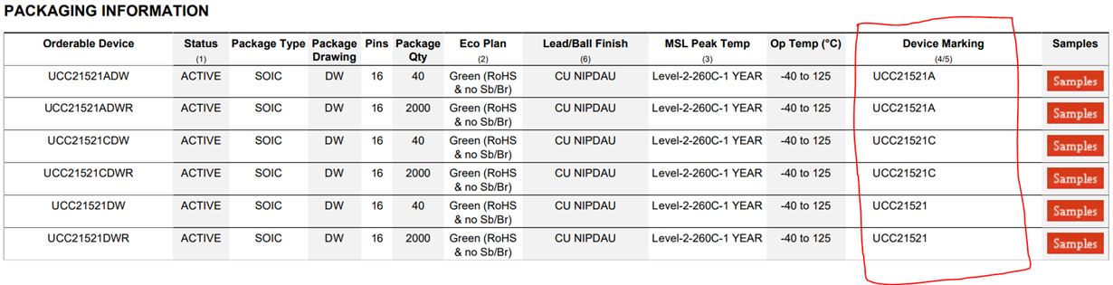

I have a number of these and all differing versions purchased from TI suppliers here in NZ , how can you tell them apart by looking at the part numbers printed on the package.
Looking at the device spec pdf, the markings on each device are not consistent with the spec sheet. None of them have specific markings like "UCC21521C" for the CDW version.

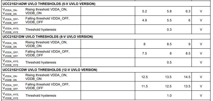

    I'm not sure I 100% follow what you're asking, but if it's what is the difference between A, null, and C, those are different UVLO options of the device. This is shown on page 8 of the d/s:
    If this answered your question, please let us know by pressing the green button. If not, please post pictures of the parts in question so we can see what information you need.

    The devices should be marked in order to designate with version the specific device is as outlined in the datasheet.
    If you want to send pictures of your devices, I can look to confirm which version they are.

    Supposedly the devices I have are are a mixture of CDW and DW types, however all their part numbers have UCC21521 with no appended "C" on the device marking; seems one supplier has mismanaged their inventory and supplied me with incorrect versions, dammit.
    Cheers
