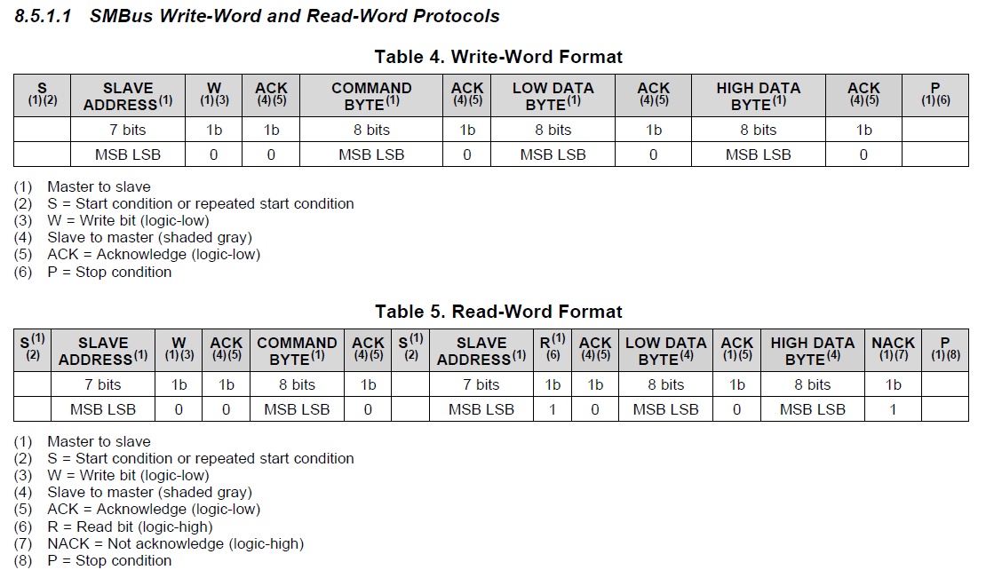

I am trying to do communication between Charger IC(BQ25700A) and STM32 controller by using I2C communication protocol.For taking the status of charging/discharging current of battery from charger ic,i have to configure registers in charger ic as shown below:
I have written C code according to given Read/write SMBus format in datasheet of charger ic but its not working. For loading current values in register address,i used array but i   am unable to understand read/write SMBus format as shown below.if someone have example related to this,please share it.
Datasheet of BQ25700A: http://www.ti.com/lit/ds/symlink/bq25700a.pdf
  • Hey Mohan,
    This may assist you since you are trying to use I2C to talk with an SMBus communication device:
    SMBus vs. I2C Communication - Charger Implementation.pdf
    You will also want to confirm how you are sending your data packets as well as the slave address to which you are writing.
    Joel H
  •  Thanks for your reply sir,your given information is very useful.As you said SMBus is a subset of of I2C communication protocol so instead of SMBus i written I2C communication protocol in my question means both the devices communicating through SMBus.I am sending data packets as per the SMBus Write-Word protocol and receiving the data as per the SMBus Read-Word protocol as you provided. SMBus slave device with address 0b00010010 (0x12H)
    I have attached my c code,Is it right way to configure registers of charger IC?

  • Hey Mohan,
    I only reviewed lines 116 to 167 and it seems correct. The data packet structure looks correct.
    However,
    For 168 to 176, make sure you are following the repeated start command for SMBus Read transaction. I'm not sure your current implementation does this.
    And make sure your device is looking for ACKs after almost every Word sent.
    Joel H
  •  Thanks for your reply sir,as you said 'make sure your device is looking for ACKs after almost every Word sent',how can i do that sir?
  • Hey Mohan,
    You I2C protocol implementation should already include an ACK to be compliant with the protocol specifications. If you follow the I2C spec, there is nothing else for you to do.
    Joel H
  •  Thanks for your reply sir,I know that the ACK is already included in I2C but my question is that how can i check that whether the sending the data from master to slave is correct or not?Means how can i know that master sending the right data and slave receiving the same data? For that we have to know the status of ACK bit,am i right sir?
  • Hey Mohan,
    First, I2C transactions will fail if there is no ACK signal.
    Second, if you want to do a sanity check in your code, you can add a I2C read transaction after each write transaction to confirm that the data you sent over to a register address is the same thing that the charger reads out to you.
    You can check something, for example, like the ChargeOption0() register and confirm that disabling the watchdog timer actually occurred.
    Joel H
