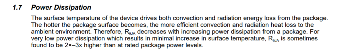

I have noticed in the datasheet that the Junction-to-ambient thermal resistance (44.5 °C/W) for the device is lesser than the Junction-to-case (top) thermal resistance (54.2 °C/W). Can you please explain why is that so because my knowledge says that normally the former is higher.
