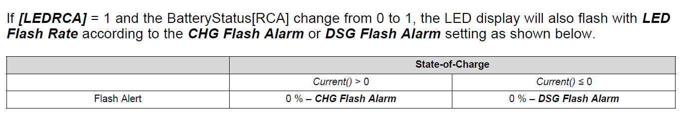

My meanings which LED be light while only Press the button during discharge.
Whether it can be light during discharge? Like:Charge
Attached file for your checking.20200123 Sy2200 4S4P LED.gg.csv
LED Configuration | 000e | hex |
Hi Mike,
Here is what I have found far.
The LED display can show the state-of-charge during discharging if the /DISP in pressed.
Andy
Dear Andy:
Whether TI can add LED flashing if discharging to TDA? Like:10% or 7% according to our setting.
Dear Andy:
My meanings LED can be flashing during dischargig process and met RCA if not press DISP pin.
