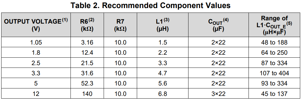

My customer is working on a design with these specs:
Vin=12V ... 18V, Vout=5V, Iout=1A
and he wants to use a 15uH inductor.
What is the inductor saturation current he should choose ?
And do you have general guidelines for choosing the saturation current ?
