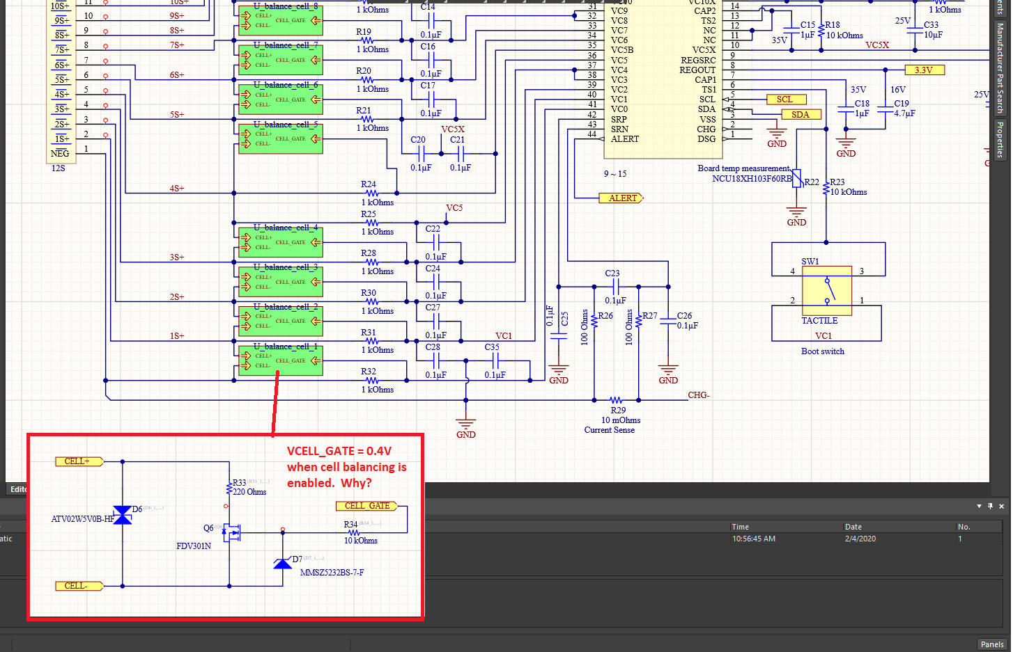

  • Hey Matt,
    All my cell balancing circuits seem to be working except the first cell.  Can you take a quick look at this schematic again?  The gate drive should be approximately equal to 2V (the cell voltage / 2), but I only see 0.4V.  It seems to me that the BQ76940 might be clamping, like maybe its damaged or something?  I checked to make sure the zener diode polarity is correct, and that R31 and R32 are actually 1k and R34 is 10k.  I've simulated the circuit in LTSpice with simple switches for the BQ76940 and it seems fine.
    Let me know what you think, thanks!
    Erik
  • Hi Erik,
    The schematic looks good, so I'm not sure why the voltage would be so low on the FET gate. It might be damage to the device.

    Today I left the board alone, when I came home I noticed that SCL was pulled low, my microcontroller couldn't communicate with the part.  After disconnecting the battery pack and reconnecting, SCL was fine.  Do you know of any reason why the bq76940 would pull the SCL line low permanently?  I wish there was a reset pin so I could reset the controller.  I'm a bit worried now...
    UPDATE 1: It seems that the ALERT pin is high most of the time and clearing the status register doesn't clear the fault.  I guess this chip is damaged, I will try to replace it.
    Unfortunately I need to use a connector to keep applying the battery pack to the chip, so I can't guarantee which cells are coming up first.  I have lots of TVS / Zeners around the circuit for protection, but do you think the out of order sequencing can damage the chip?
    UPDATE 2: I replaced the bq76940 with a new one.  After building the pack up from cell 1 to cell 12, I again get the SCL low problem.  Then after yanking the connector out and then back in fixed the issue.  But I noticed that I didn't have a delay from power-up to I2C start.  So, I was trying to communicate with the BQ76940 before it was ready, but I wouldn't expect it to yank SCL down indefinitely, was just expecting a NACK.  In addition, I still see that cell 1 is not balancing properly due to a low gate drive (0.4V) for the external MOSFET.  So, I think these issue are looking more like a design problem then a damaged part problem.

  • Hi Erik,
    Sorry to hear about the issues you're seeing. SCL should not be driven by the BQ76940 since it is a slave. Are you sure the MCU is not driving this low? Do you see any faults in the status register when the ALERT pin is driven high? You may also need to clear the fault condition that is causing the Alert pin to go high.
    I will go through the schematic and look for any potential issues. In the mean time, it might be good to review Section 10 of this app note if you haven't already about random cell connection: http://www.ti.com/lit/an/slua749a/slua749a.pdf
    Matt
  • Ok, I guess I was thinking its possible that the slave holds the SCL line low because some slaves do that for clock stretching.  I will see if I can isolate just the microcontrioller.  Yes, I can clear the fault in general after the ALERT pin goes high, but there have been a few cases I've seen where clearing the fault has no effect and the ALERT pin stays high.
    Thanks for the Random Cell documentation, I see this sentence:
    If the VC0 input is not connected to battery-, it can be pulled to a high voltage. While no damage was observed at TI from this condition in limited testing, connecting the bottom of cell 1 input to VSS on the board at least during cell connection is recommended.
    So I suppose its possible that I'm damaging VC0.  The 0.4V voltage I'm seeing seems like it could be an internal body diode, like there is a resistive short internally to a higher voltage, so you get this sort of diode drop that is pull-ed up to another voltage.  But unfortuantely we don't have access to the VC0 pin directly to connect to Batt- during the connection process, I would need to update the schematic and use a jumper or something.
    EDIT 1: On second thought, if you connect VC0 input to the battery- the cell 1 will be discharging.  I'm not sure I understand this recommendation.
  • Hey Matt,
    I built up a new board and this time did NOT do random cell connection.  I've observed that cell 1 is now operating properly.  So I believe that random cell connection is not advised for my setup, as VC0 was damaged in both parts I tested.  I'm not sure if this is because I was using NMOS balance transistors (vs PMOS that TI normally uses) or what, but I have a path forward now.
